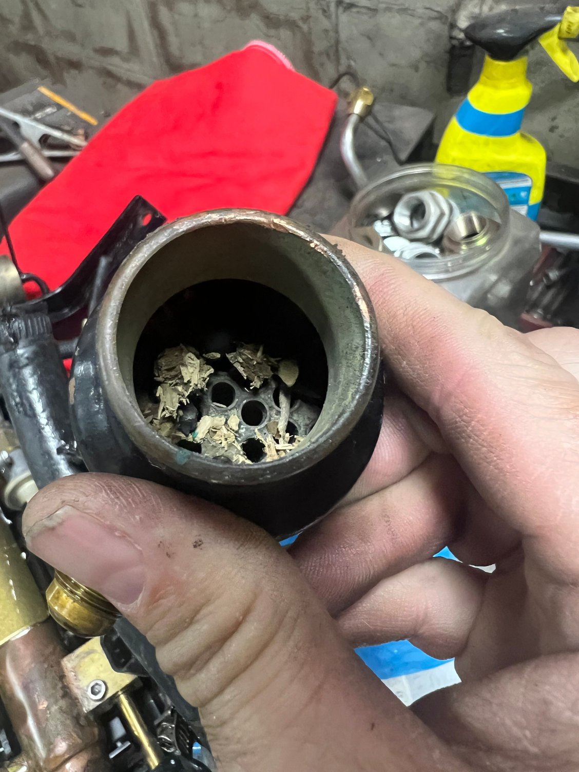

liberator221 03-21-2025 07:09 AM
Originally Posted by bajaman (Post 4922544)
I am a bit worried about the pieces...there were a couple of pieces missing on the old impeller...
When I was 40 years old, this would have been far easier...nearly 65 and, while the mind is willing, the body says, "WTF are you DOING???"
I believe most of the pieces will be in oil cooler, hopefully in the bottom. If it is like mine ( 98-502) hose from pump goes to P/S cooler first which is just open pipe so they should gon through, then on to oil cooler which has tubes in it. Gpes through cool fuel module before oil cooler if you have that.
Brad Christy 03-21-2025 08:02 AM
Liberator,
https://cimg2.ibsrv.net/gimg/www.off...923bcb6e4.jpeg
https://cimg4.ibsrv.net/gimg/www.off...54efc656c.jpeg
That’s where I found them.
In my defense, those impeller bits are from a time before we owned the boat. Every impeller we’ve changed has been whole when it was pulled. :cool:
Thanks. Brad.

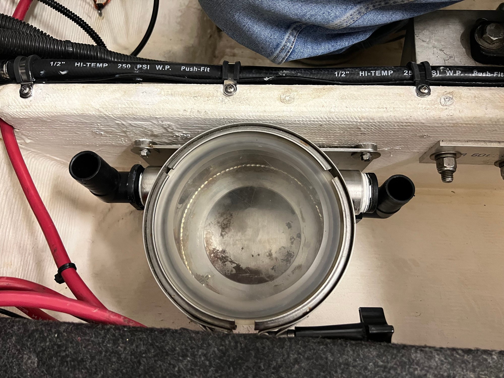

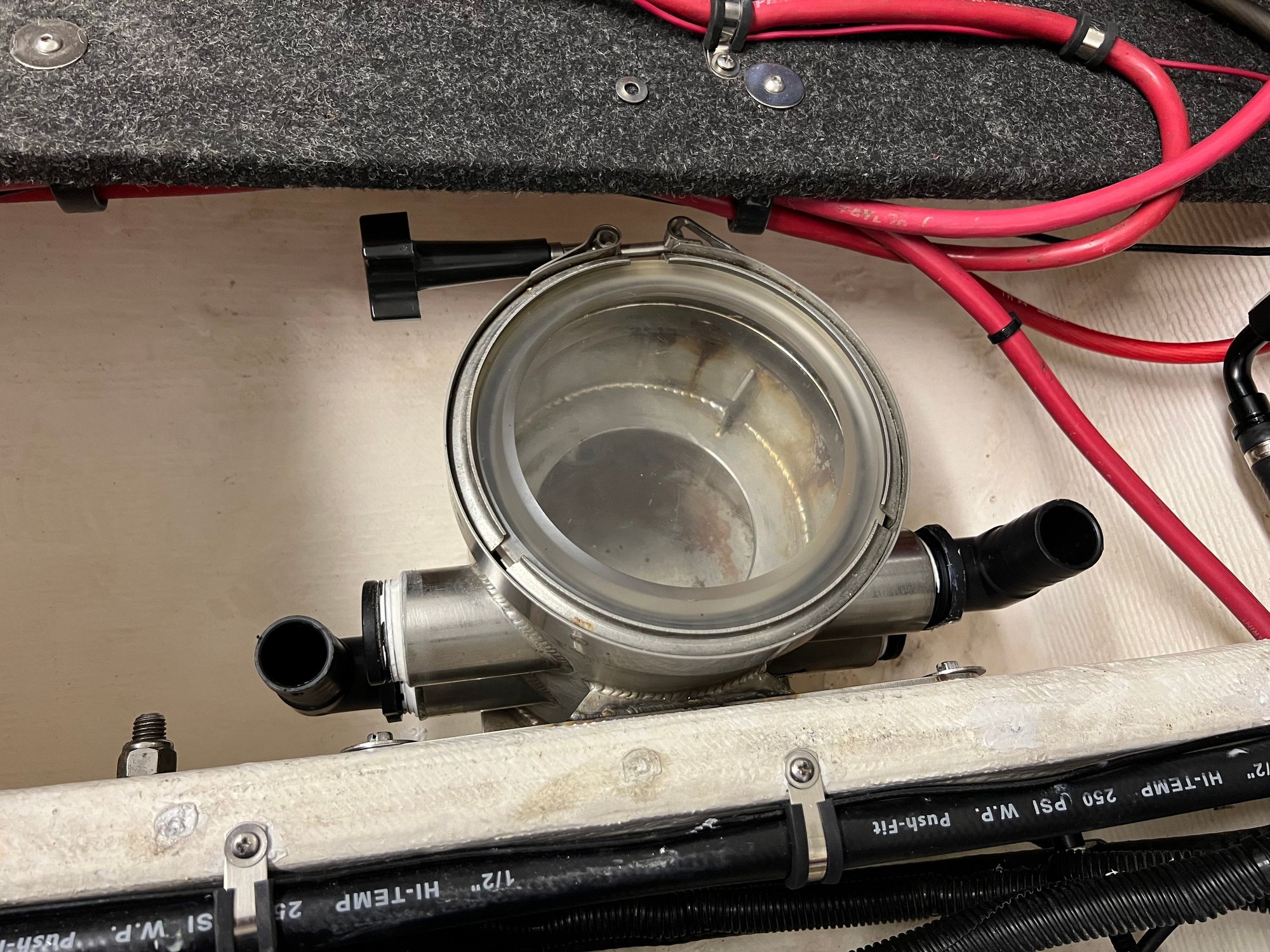

This image is why I'm installed a sea strainer between the bravo3 leg and my sea water pump lol.. I know that won't keep impeller chunks out, but I wonder how many impellers get shredded from debris in the first place... not so much just age..
Brad Christy 03-21-2025 11:41 AM
AShipShow,
https://cimg0.ibsrv.net/gimg/www.off...b66119f80.jpeg
https://cimg2.ibsrv.net/gimg/www.off...720df8856.jpeg
https://cimg3.ibsrv.net/gimg/www.off...cb3111961.jpeg
Me too.
Thanks. Brad.
