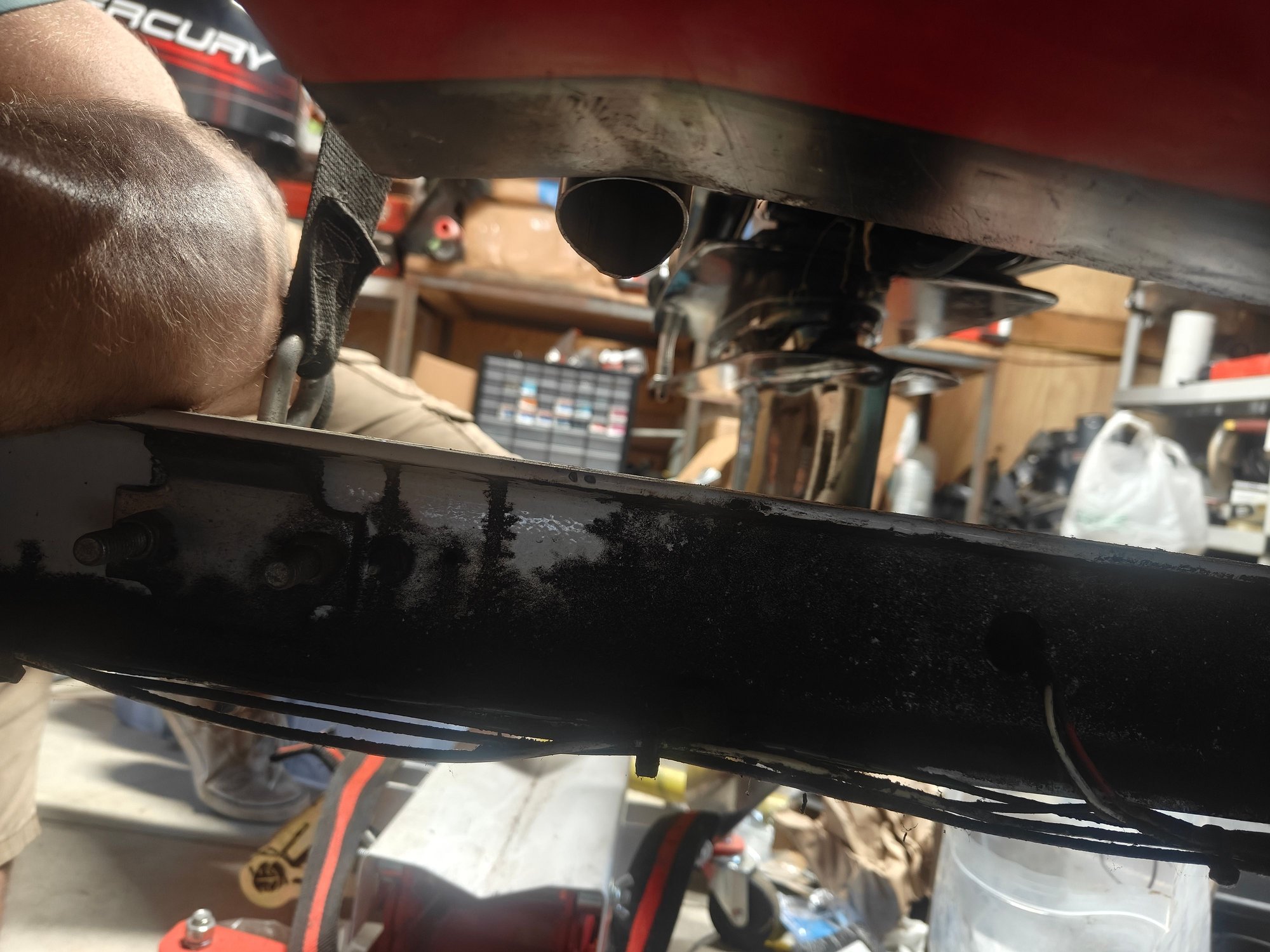

This was outcome after trimming, tricky positioning
