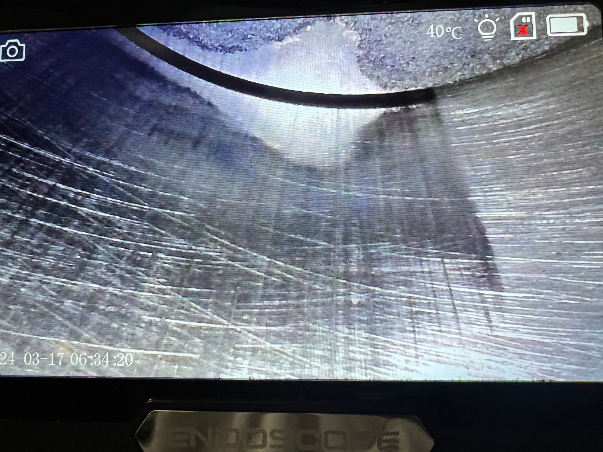

Borescope
Checked each cylinder, some scoring (see picture) but no obvious signs of damage - valves look good and visually close.

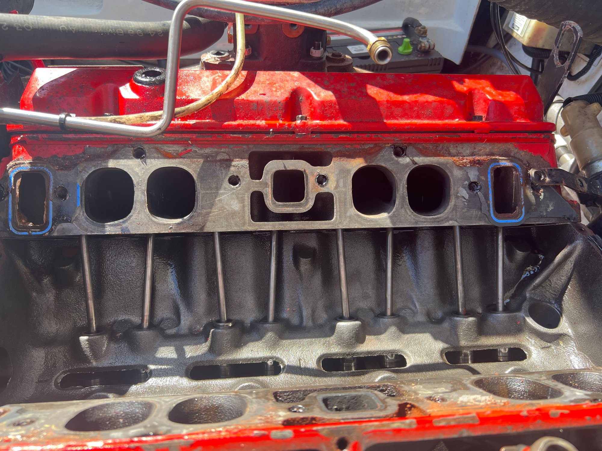

  • I tried tightening exhaust valve on #1 with engine running (as closest to source of sound) and clacking dropped but engine bogs and dies (assume indicative of valve staying open). Other valves tightening did not effect the sound. This led me to assume a stuck lifter - I pulled lifters on #1 and they were both pumped.
  • I inspected the camshaft - no visible signs of wiping - cams are all there.

cam exhaust lobes on 2 and 4 look suspect,,lifters don't look to be out of the bores the same as the other lifters

Rockers look OK - and lifters look fresh, which has me concerned that maybe they changed them when refreshing the heads and didn't change the cam at the same time. I will be back to the boat next week with fresh gaskets and will investigate the cam more closely (ref comment about #2/#4 lifters - thanks). I will pull all the lifters and clean them out for good order, and put her back together and see what happens.

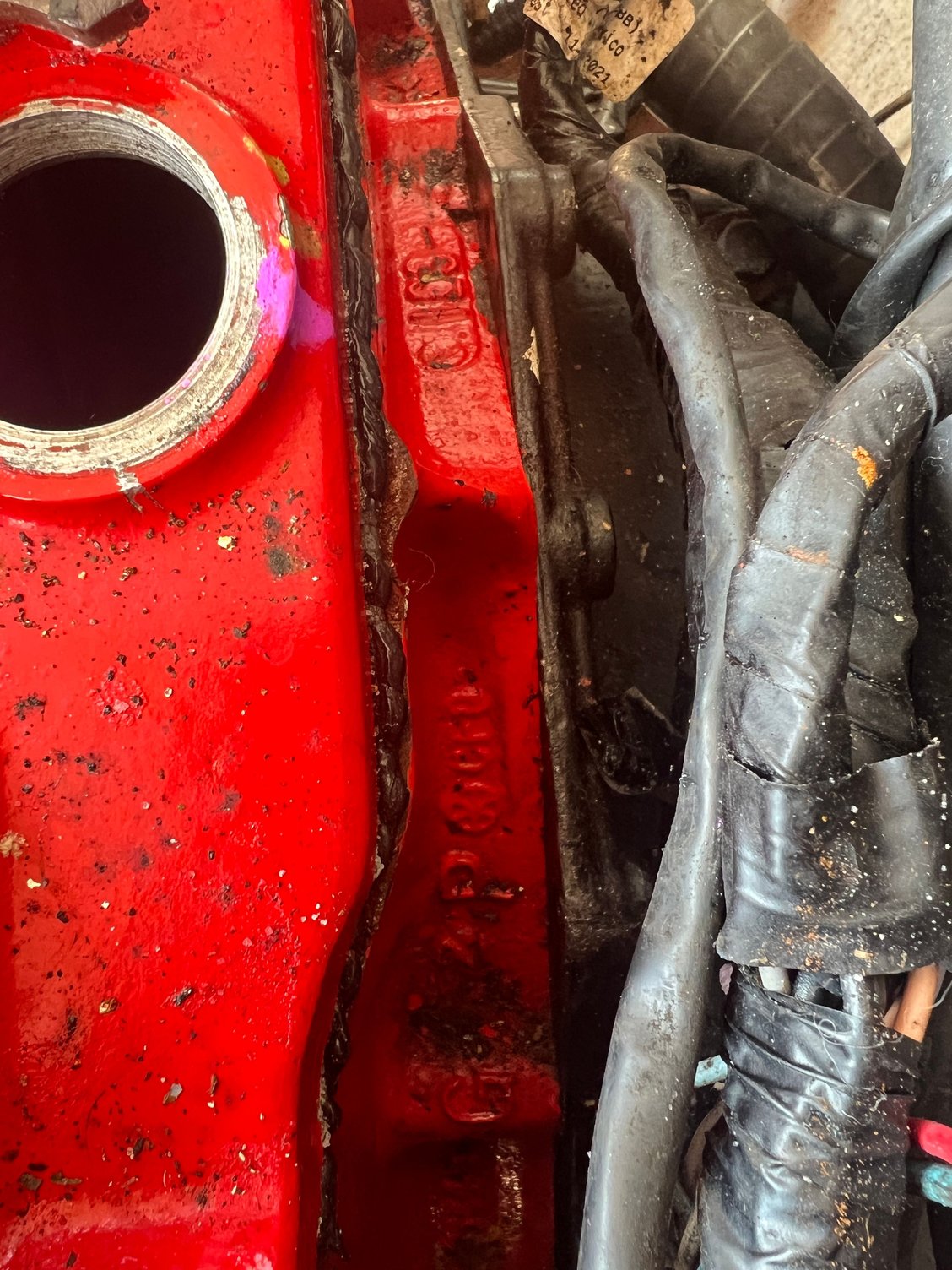

Check the flywheel area too. Loose bolts can knock pretty loud. Does sound like bottom end though by frequency.

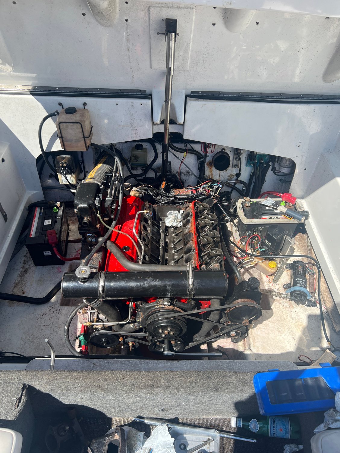

Engine looks awfully dry
F-2 Speedy is online now
Can you expand on that? The dipstick was showing oil, and oil pressure Ok.
How can you tell it is dry, and what might that imply?
Thanks
Will
drumwilldrum is offline
Old 06-07-2025 | 04:37 PM
F-2 Speedy's Avatar
Posts: 11,441
Likes: 3,973
From: Midwest & T-Rock
Is there oil in the lifter pockets or puddling on the rocker arms above the valve stem, maybe its just the picture
