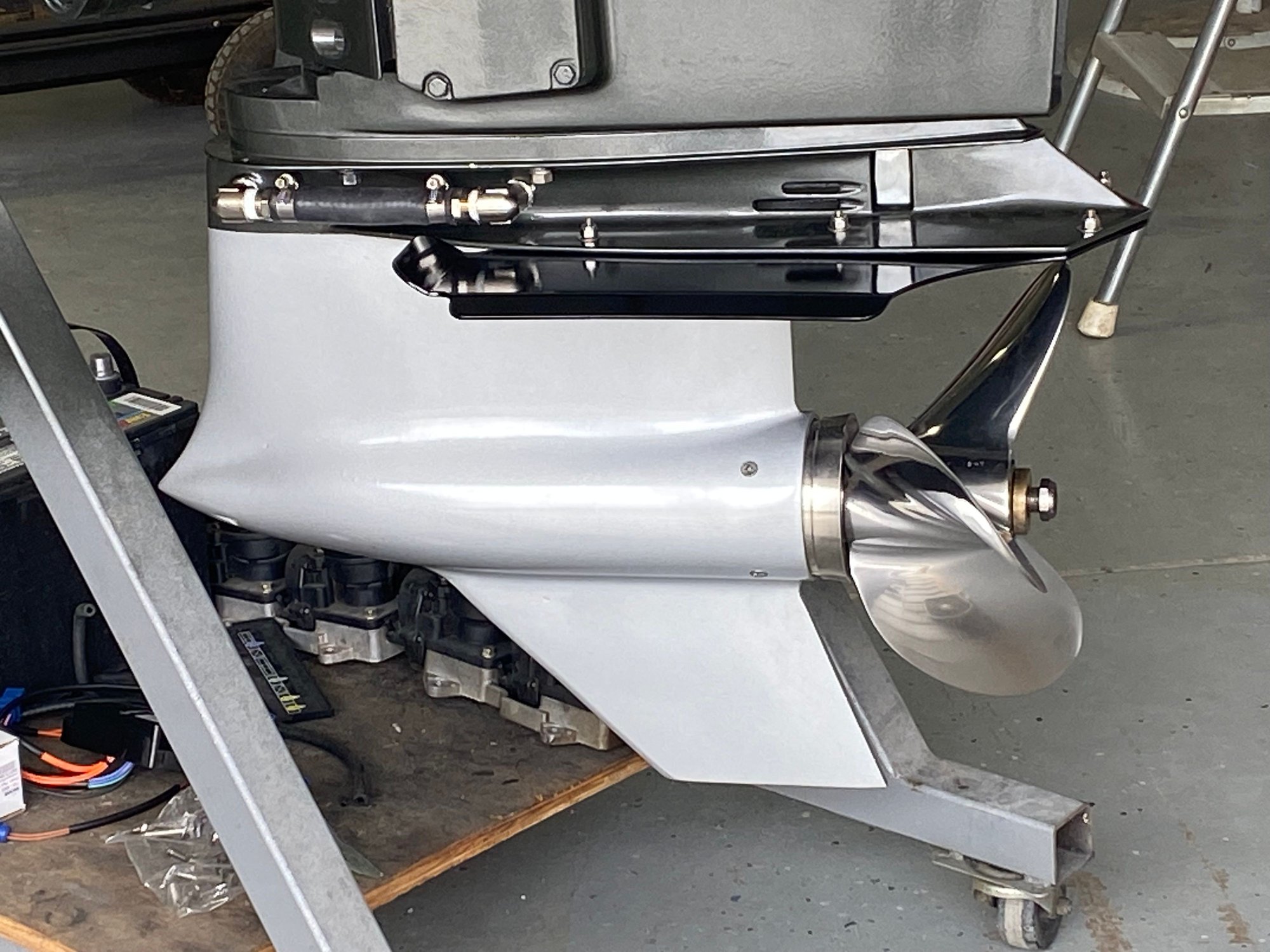

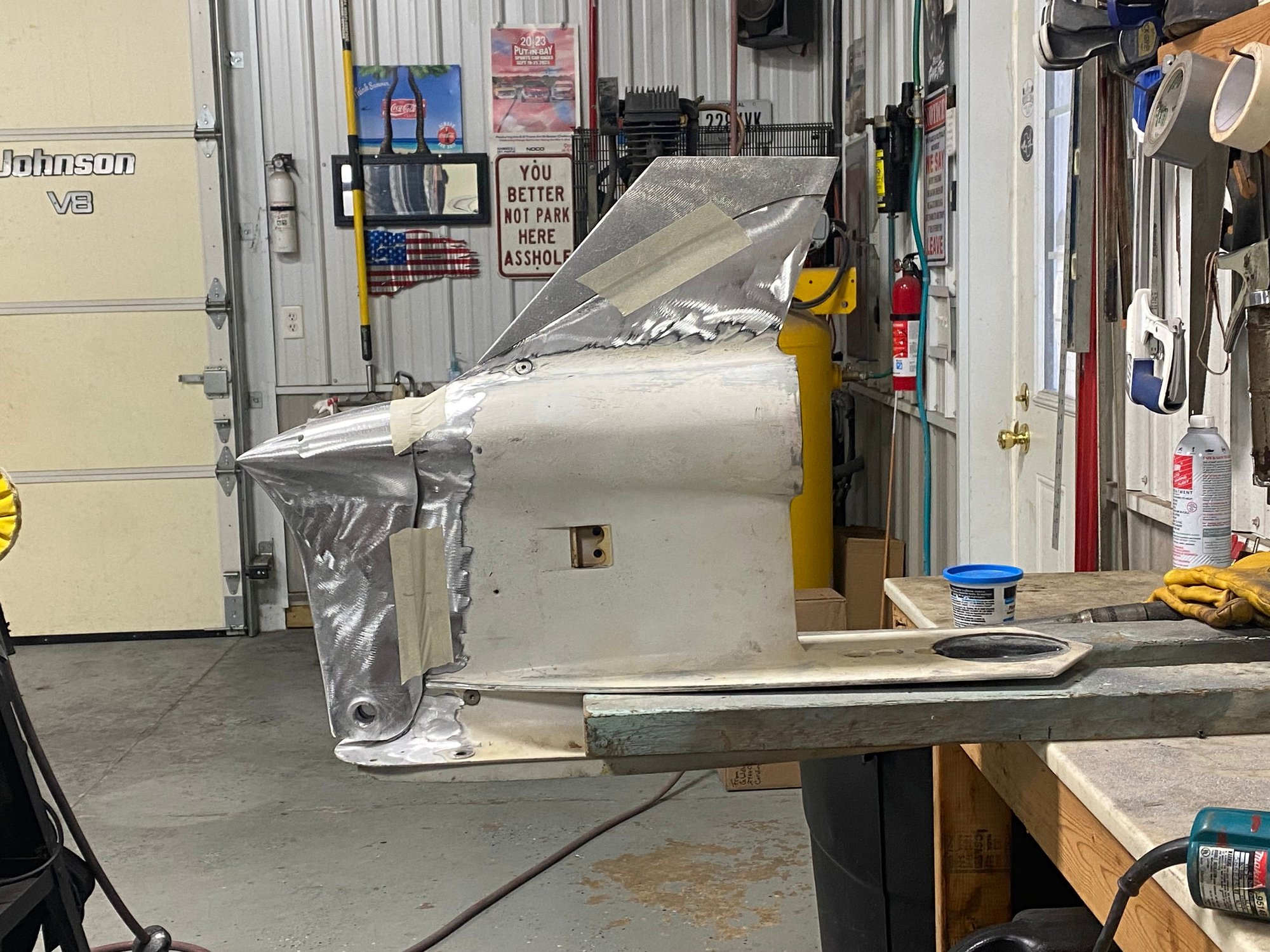

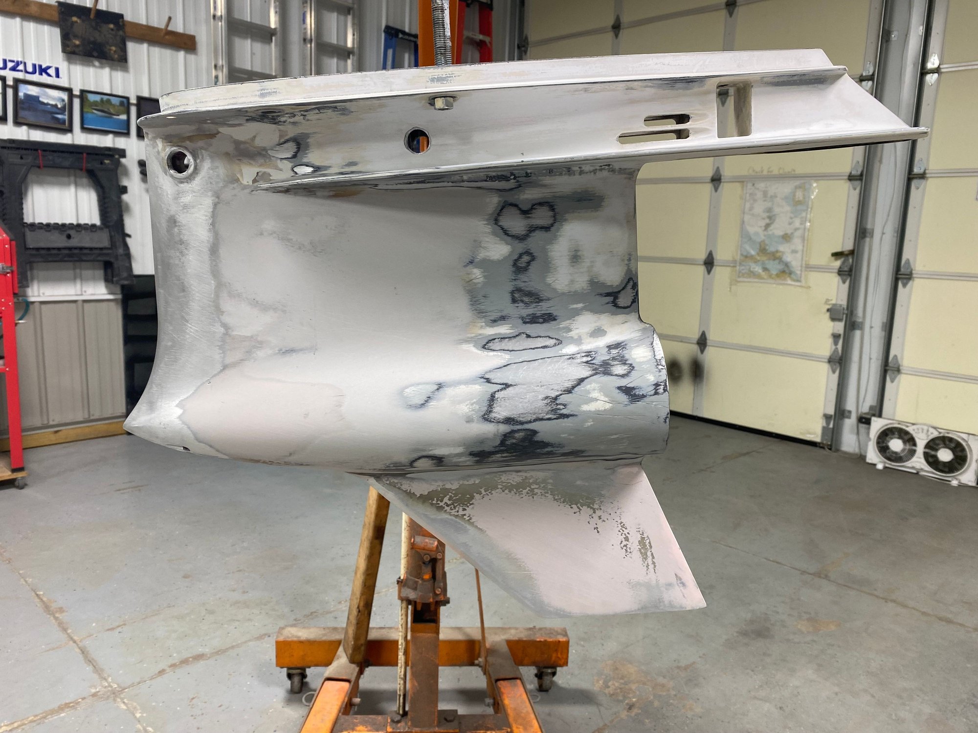

I’ve done several on my 100 mph OBs and just had this one done.
It wasn’t due to damage it was due to the poor OMC design for hi perf apps.

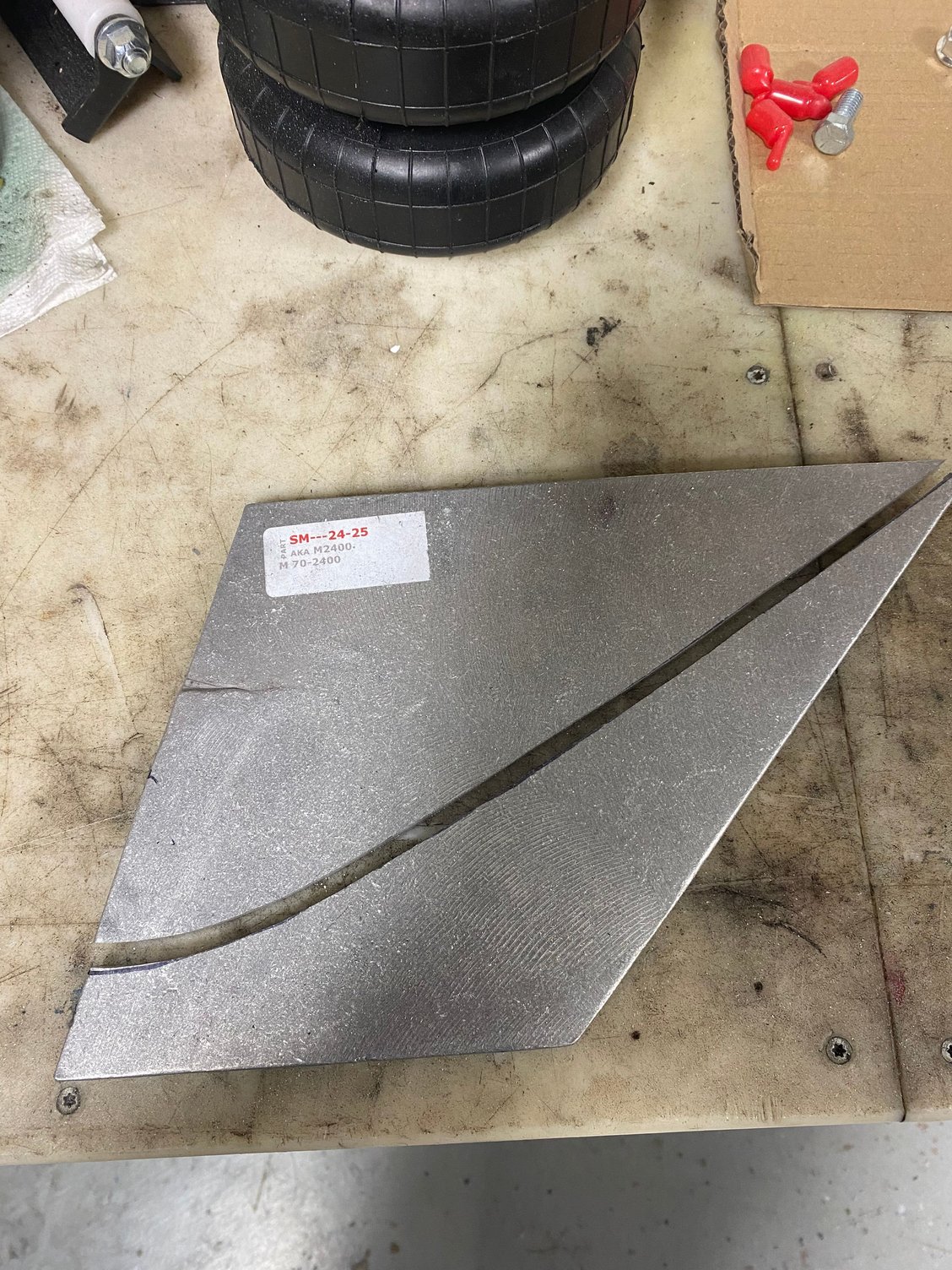

As mentioned in an above reply, Bobs Machine Shop offers replacement skegs, in most styles/sizes.
I bought a replacement skeg for a Merc Sportmaster then had it welded to my OMC case.
Part of what I’ve been told for a good weld on these is that the pc’s are “normalized”.
As in, the parts are pre-heated prior to welding then re-heated post welding, to slow the cooling process which prevents cracking.
These parts were in front of a torpedo heater pre and post welding.
I learned this process when I had a 20” OB mid section shortened to a 15”.
I have friends that have had this done by “experts” in that field and have repeatedly cracked at the weld.
From what I could learn, none of them were “normalized.
(also added the nosecone)
