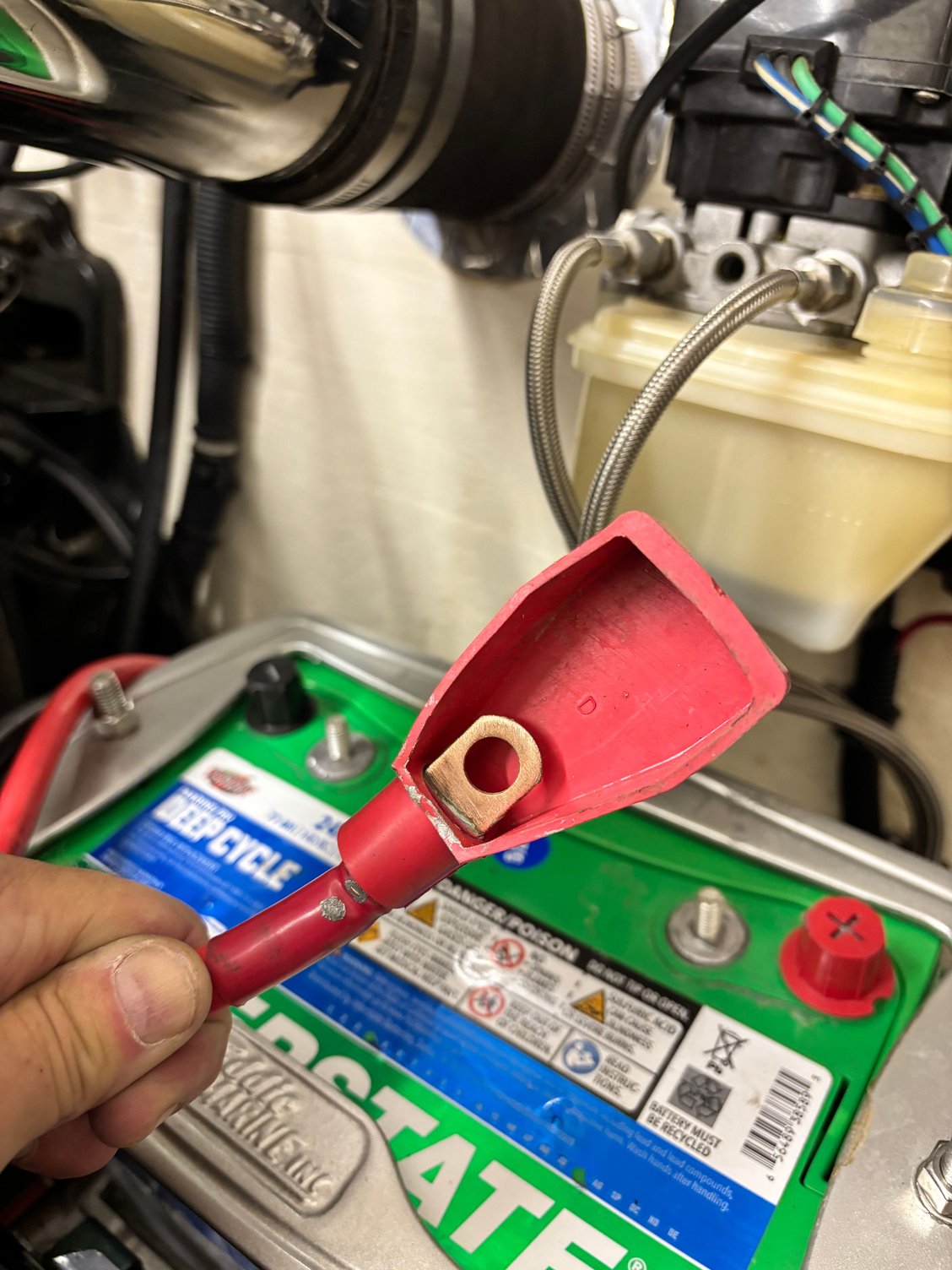

Spent several hours today removing and sanding every connection, and spraying electrical cleaner to every plug that I could find in the ignition or charging circuits. I wasn't finding much.
I did find a Mercathode system wire that had worn down to a bare wire, which I repaired, but don't think that would cause the problem I am having.
Finally decided to remove the battery cables. On the 4th and last one I found this.
I think this might be the culprit. It had worn to bare metal against the battery box and was probably shorting out on occasion and causing problem.
What do you think?
I'm going to ty and get it out this week to see if the problem persists.
Revd Up is offline
What do you think?
RevdUp,
Is there actually a route to ground from that point? Even if my battery trays were made of metal, there'd be no connection to ground.
Thanks. Brad.
Brad Christy is offline
Old 09-30-2025 | 07:34 AM
Joined: Jan 2001
Posts: 1,132
Likes: 54
From: Rockford, IL
Good point. I think there is, but I will be checking into that.
Revd Up is offline
