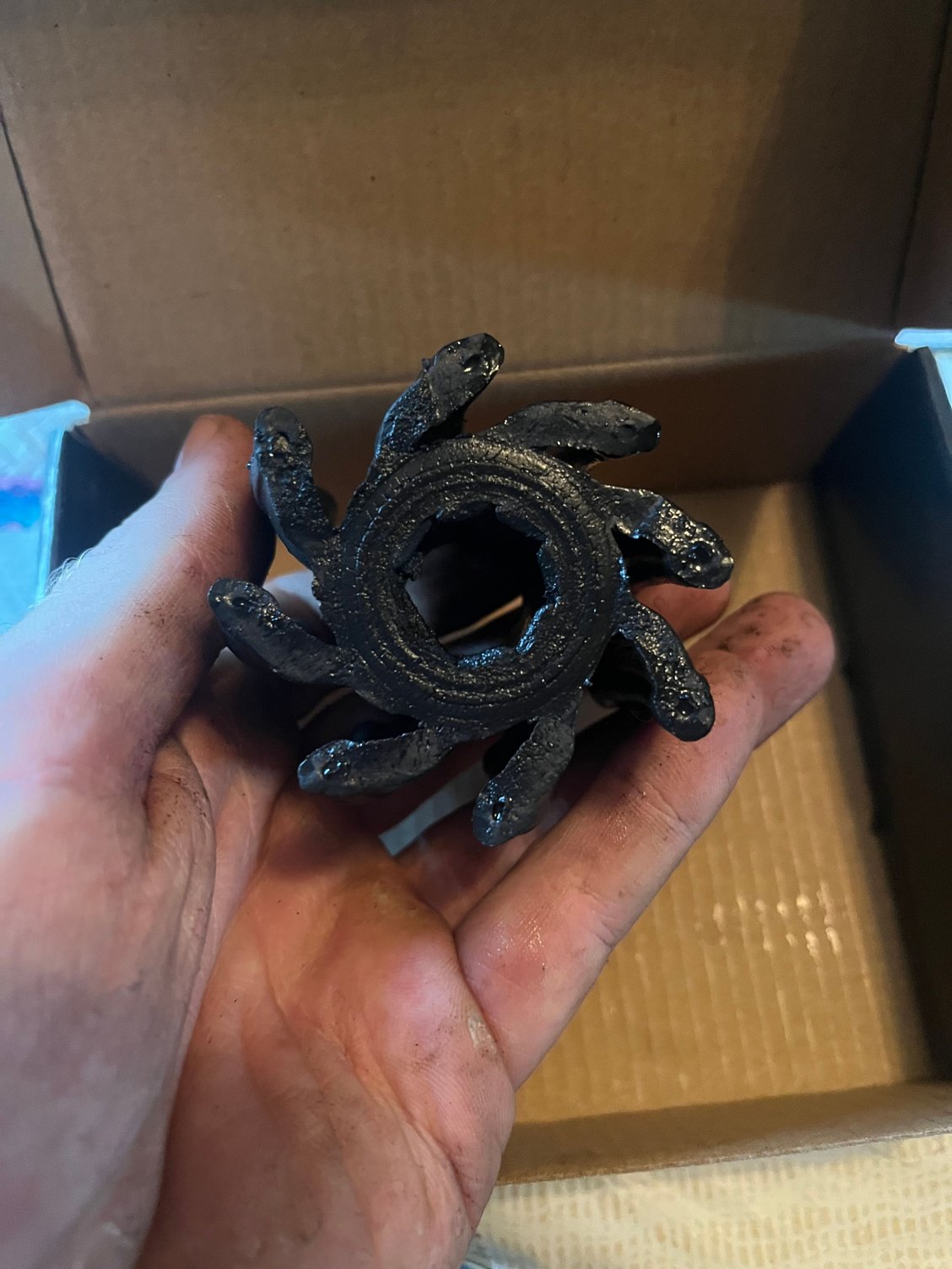

Maybe someone else has something to say but it looks fine to me.
Well…. Now I can kinda see

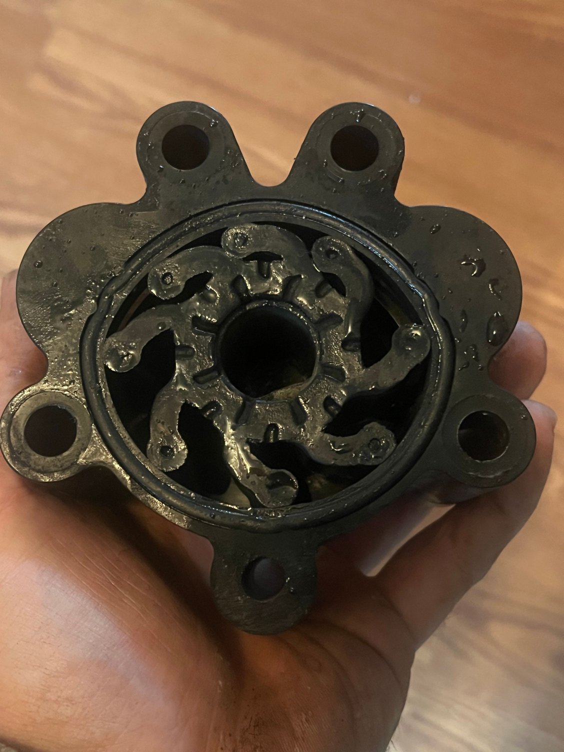

Old 11-02-2025 | 03:32 PM
Joined: Jul 2018
Posts: 163
Likes: 9
Originally Posted by liberator221
My experience, if housing is 6 years old it is scored. Is impeller that old? If so it needs changed.
Is this acceptable scoring?

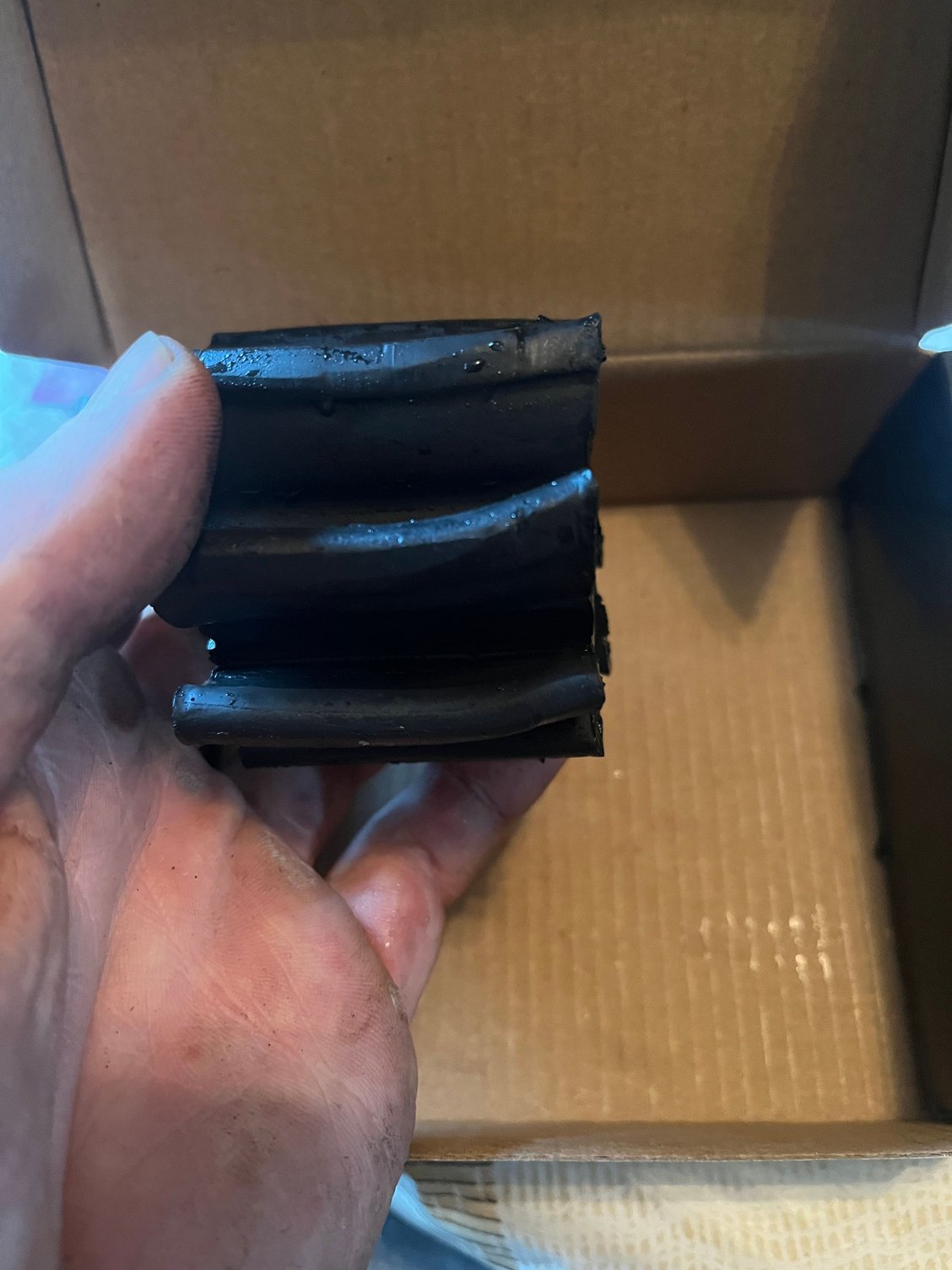

Old 11-02-2025 | 04:53 PM
Joined: Jan 2007
Posts: 2,096
Likes: 1,217
From: Murrayville Georgia
that was junk several years ago. the fins should stand straight out. they are bent due to none use and will no longer make a good seal when turning. always replace the housing at the same time as it is not worth the hassle for the minimal cost.

Old 11-02-2025 | 05:03 PM
Joined: Dec 2022
Posts: 117
Likes: 72
From: Mason, OH
That impeller is junk. Needs replaced. Need to check the pump housing as just mentioned. Usually just replace them together as its Aplastic housing that gets grooved in it easy.
