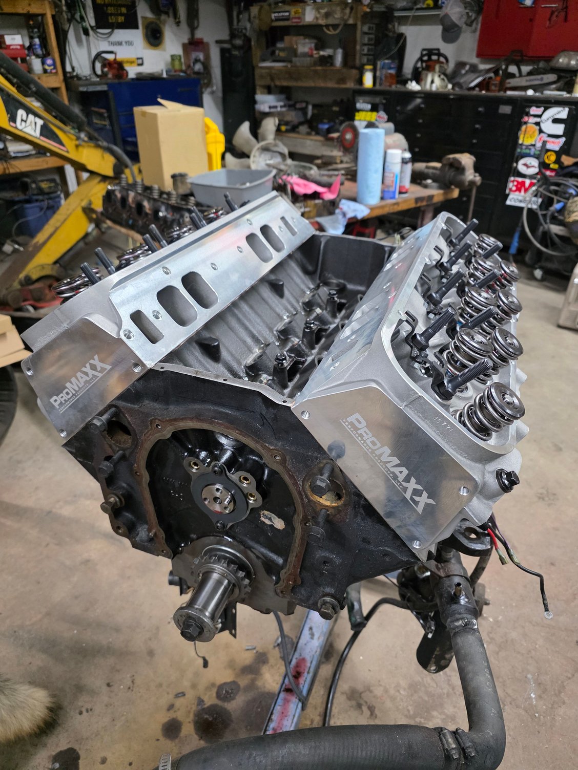

I just torqued down my ProMaxx 290 heads yesterday. I am using the same 500 EFI cam on a 454. I had ProMaxx assemble the head using inconel exhaust valves ($500 upgrade per head) and the upgraded .650 lift springs (150/500)
The heads include adjustable pushrod guides and studs, I have heard of a couple guys saying the installed studs are a tad short. We will see
I am using Comp Ultra HD rockers and will be checking pushrod geometry in the next few weeks
