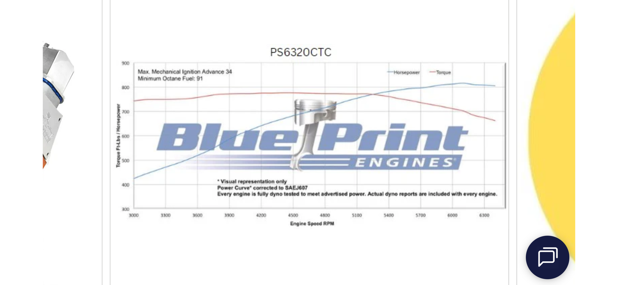

If Im reading their description correctly, yes exhaust alignment issues............300 + .700 = approx 11/16 of an inch. ........thats a big thumper cam, Id get a dyno sheet and find out where it makes peak and torque.........my guess is peak hp is in the 6500 to 7k range
OK I read it as the exhaust is .300 higher, just over 1/4". I didn't realize you added it the deck height as well.
I just talked to BluePrint. They said they've had quite a few people run this engine in a boat with "great success". He knew all about reversion and sad that street Cam is borderline so keep an eye on it. The only difference between the marine and street versions is the cam and a thicker stainless head gasket to dump down the CR a bit.

I was going to mention possible head gasket change to lower compression........... 10.2 vs a 9.8 deck then ad the raised ex port is a pretty good jump.............plus the tall deck is a little over an inch wider, but its doable with custom tails
