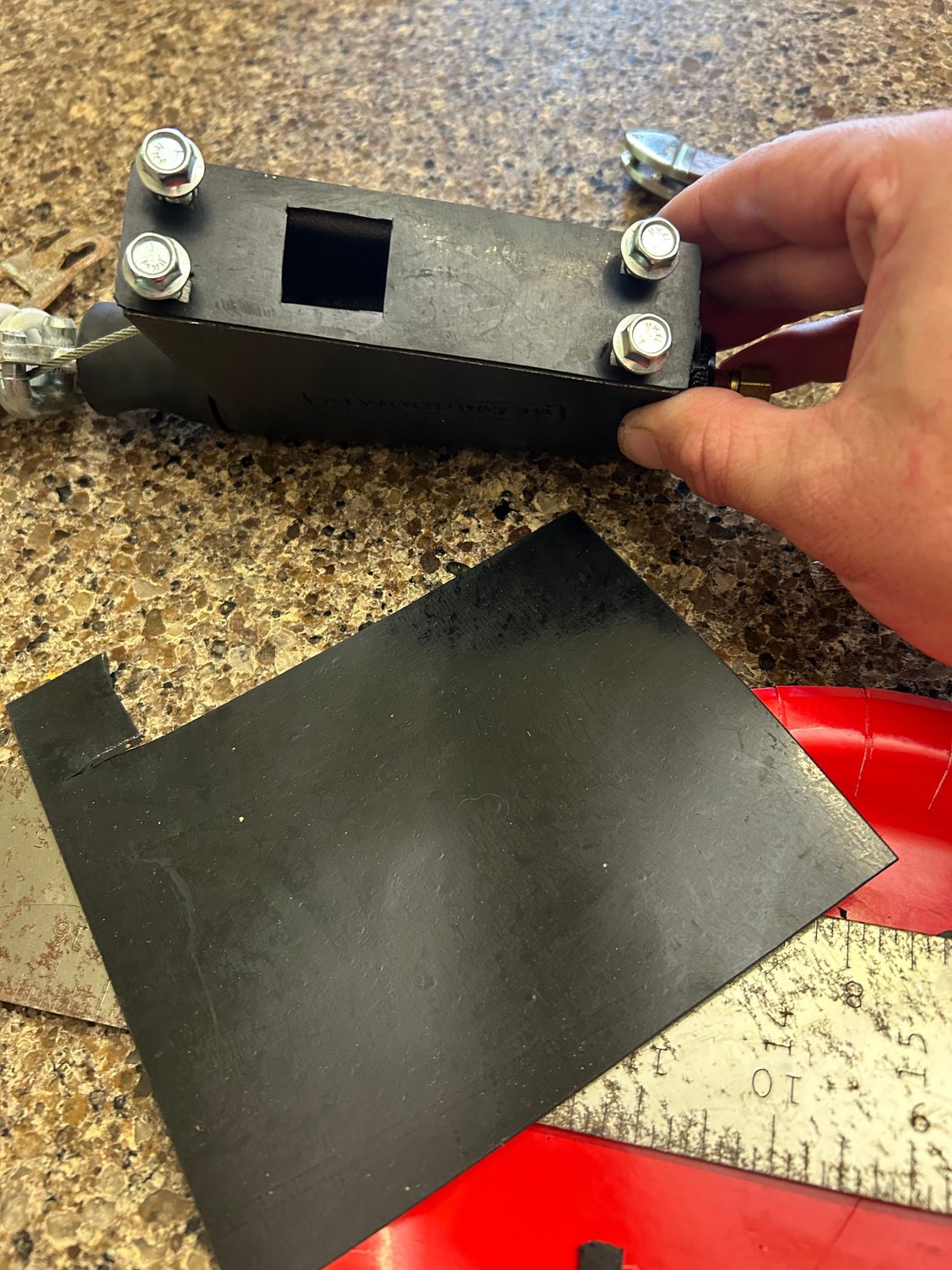

Brake problems on my new to me boat trailer keep snowballing… Started with new pads, then a caliper, then master cylinder, and most recently a brake line. The annoying part is I have to hunt and order everything and new issues show up after each part arrives. I’ve been working on this for weeks.

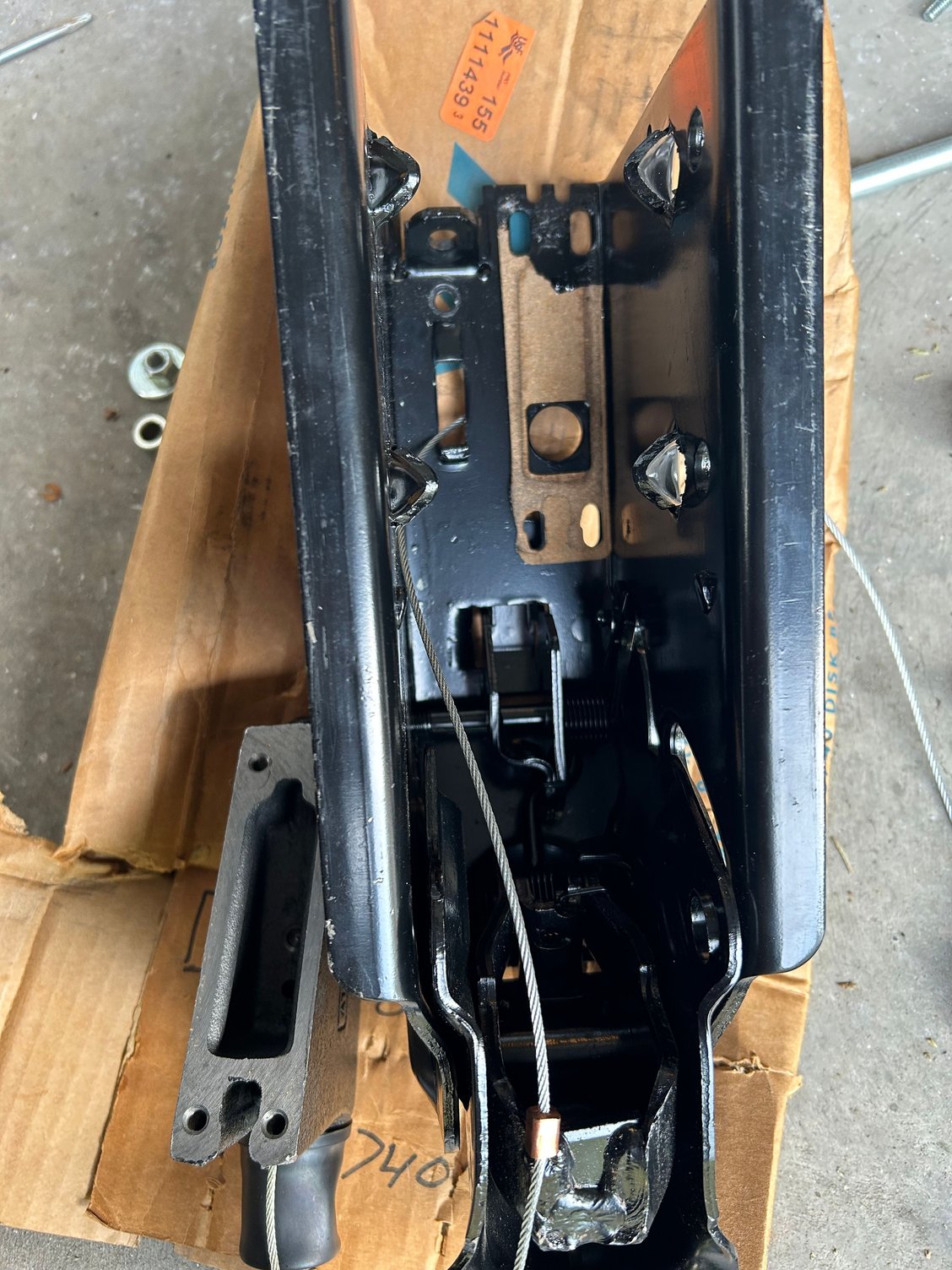

The master cylinder is discontinued but I got lucky and someone on Market Place an hour from me had a brand new actuator. I was switching the parts and sure enough, I wasn’t able to reuse the gasket.
Talked with etrailer today and they can’t get one nor do they have a similar one.
Chat GBT says I should use an EPDM material to make one. I’m finding sheets of it but not exactly sure of the pressure rating.
Old one kinda looks like a cork rubber gasket but I don’t think cork rubber is glycol resistant.
Can someone post a link to something that would work? All the google and Chat GBT info is overwhelming and I’d like to make sure to fix it right the first time. Greatly appreciated!

I am not familiar with that type of master cylinder but, a normal master cylinder does not have any back pressure unless itis some type of air assist. The thickness only needs to be enough to provide a leakproof seal between the 2 mating surfaces because it is not a perfect machined fit. I would assume a 1/16th would be more than plenty. Or possibly even less. Good luck, keep us posted.

They have been for me also except for this matter. Parts are discontinued. They recommended I replace the whole actuator. Terrible suggestion. But I will give them credit for the 2nd time I called about this matter when I found the actuator local and needed a gasket. He also suggested replacing the whole actuator. I mentioned that would be crazy for a gasket… I emailed him pictures and measurements of what I needed. He did try to find something similar in the warehouse.
