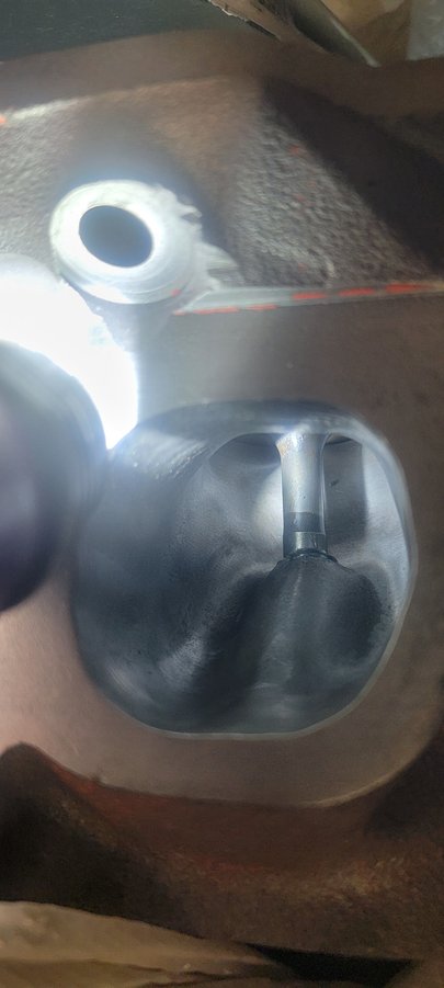

Here is the 2nd set of 781 heads i ever ported. I have the on the bench waiting to go on another 496 for my truck.
these flowed 311 on intake at 600.
Exhaust flow was 232 at 600 lift
I like looking at 400 lift numbers. These heads flowed 272 at 400 in intake and 187 on exhaust. This is very stout 400 numbers for a production iron head. Years ago I did a ported set of peanut port heads with a 2.25 intake. Never flowed them but the 489 inch truck motor put out over 650 torque and still did 511hp at 5200. Torque peak was at 3900. Stroub hydro roller.
