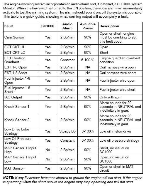

[QUOTE=thirdchildhood;4757954].........
In this chart only possibly fault is over heating. But they check and change only idle air control valve, but we told to that might be faulty thermostat and water temperature go high with full speed.
The meter shows about 120-130 about temperature while we drive. If I remember correctly.

If over heating is the problem pull the end caps on the heat exchanger on the front/top of the engine. The rubber deform and blocks the flow.
