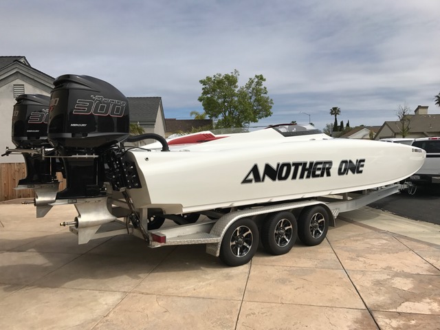

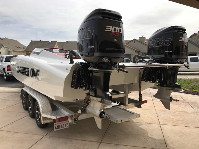

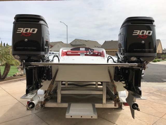

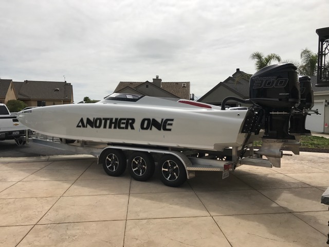

Dan brought his 28 over to my place so we could install water pressure relief valves on his XSs. I found out with my 28 that as soon as you start running high teens, the XSs can't bleed off the excess water pressure, so we knew he'd need them on his 28. The seats are out of it right now, as he's having a few tweaks made to them to suit his personal preference. As soon as the seats get back, Dan will go out and put some time on the motors to get them out of break-in mode, then we'll go out and run it with a couple different sets of Dewalds. The boat looks as good in person as it does in the pics, and I'm certain it's going to run as good as it looks as well!

It sure looks amazing. We got to see it at his storage last weekend. Hope I didn't leave any drool marks on it.

I have always preferred the Skaters but the Race/Pleasure cats DW is putting out in their last couple of builds make it a definite a boat to consider if you were to put cash on the table for a new boat today!
Congrat's to the new owner - Beautiful!

Dale, What has transpired with the water pressure relief valves? I have not experienced high water pressures thru the gearcase pick-ups at 115 MPH +. My water pressure is pretty stable above 100 MPH except when turning. I did add a water balancing tube from adapter plate to adapter plate to help with the unbalanced water pressures occurring in turns.
