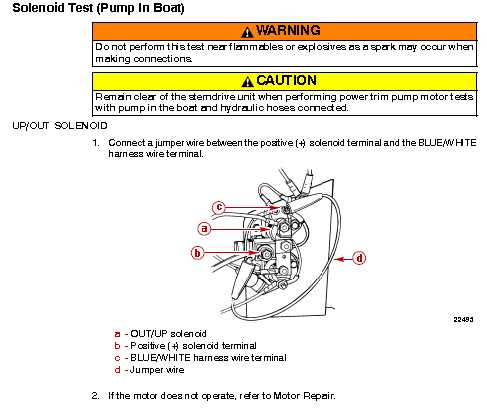

is this what I should do?

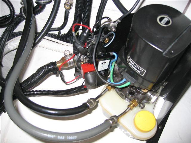

also here is pump......confused as to which wires to connect together.

hoozeyurdaddy 05-31-2007 08:52 AM
no to the first one, that is just a test to check the pump.
on the second one, the wires are there, but you can't see them, look behind the motor at the transom plate above the coupler, you will see 2 black exstension cord looking wires, they should be zip tied up so there out of way, find those wires and you will see the bullet connectors that i'm talking about.

Originally Posted by 97BossHammer (Post 2146156)
No. This first one is showing how to test your solenoid. It's bypassing the solenoid and putting power directly to the trim motor.
97BossHammer 05-31-2007 09:57 AM
OK so once I find the 2 black extension cord looking wires at the transom plate and the bullet connectors........then what do I do?
Sorry for the dumb questions....just want to make sure I get this right.
hoozeyurdaddy 06-01-2007 08:10 AM
on one set of cords, there are a male and female bullet connector, those are for the trim sending unit gauge, on the other set of wires, there are 2 male connectors, those are for the trim limit, these are the 2 wires that you want to connect together, unplug them and the wires on the engine side need to be hooked together, that should make your trim switch on your controls work, it will bypass the trailer button and you will have full control of your trim and tilt from the shifter.
