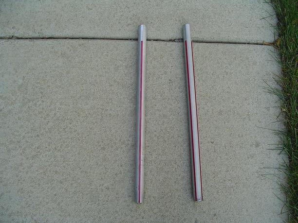

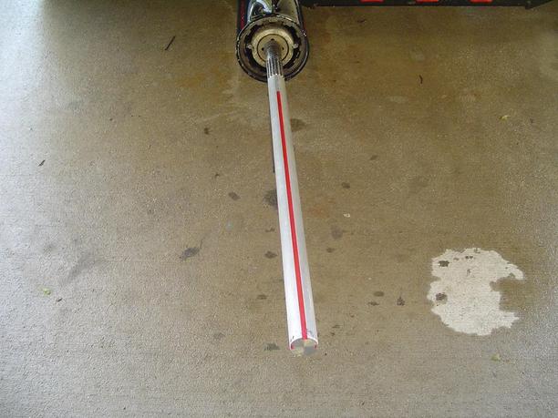

I made these earlier this year....very simple idea and saves you from crawling under the drives to get to the nose cones.....just thread them on the prop shaft and get one of the 4 red grooves to be facing straight up....use a tape measure on the front part of the bar near the prop shaft and on the back of the bar and adjust the drives till you have equal readings front and back...then you are dead balls straight.....now you can take the bars off and adjust the toe-in/out with the tips of the prop shafts simple and quick!
If anyones interested in a set let me know i can make some more
