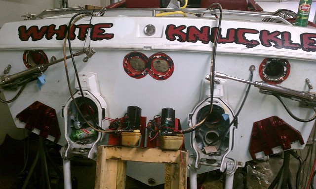

Been there just did all of that. I used a 1/2" allen socket. Mine were red loctited in. I used PB blaster on all and had to use heat on one to remove the pin. I have my boat gutted and did all the bearings, bellows, bushings, seals and had tranny's rebuilt.
