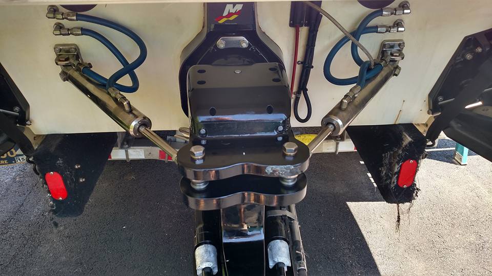

Had a customer two years ago with 700 hp in a 27' Fever. It had an SC drive on it. SC didn't hold up. Blew the upper and wasted the transom assembly at the same time.
I re-rigged him for a BMax 1.50 ratio. Boat didn't loose any speed and it's been two years since I did the job and no failures.
At the 700 hp level, you'll need to refresh the lowers every 3 seasons or so, depending how you drive it. Just change the oil every 10-15 hours and monitor the fluid. If you ever see a metal flake in the oil, keep a closer eye on it. If at the next 10-15 hour sevice there's more metal flake then the first time, it's time to tear the lower down and put a new gearset in.
I run 965HP on BMax HT's. My uppers were freshened after 300 hours with new pinion gears. The lowers I replace every other season. You gotta pay to play.... but I don't have any failures (knock on wood).
[ATTACH=CONFIG]562455[/ATTACH][ATTACH=CONFIG]562456[/ATTACH][ATTACH=CONFIG]562457[/ATTACH]
