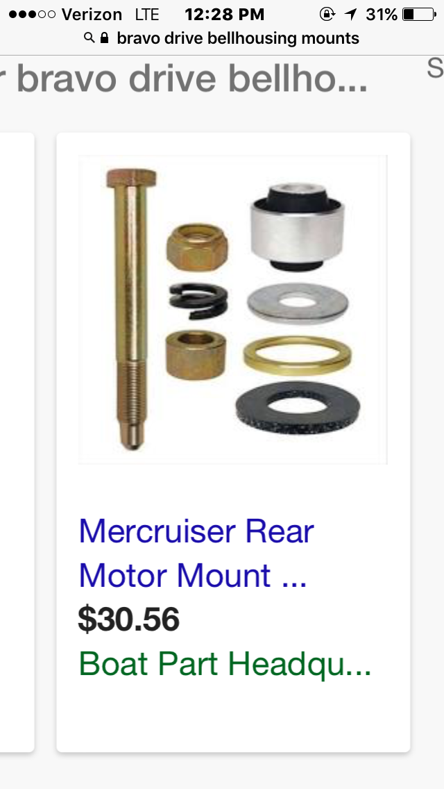

The other thing I'm wondering is, how comon is it for the aft mounts to need replacement? One on the PT motor thats easy to see looks iffy... Is this the correct kit?

last picture, looks like the housing is cracked ?............the new bushing kits I bought did not require the spring, said throw them away, guess it depends on the kit
Thanks for looking at those closely, I thought the same thing but its just a strange blemish in the powdercoating. Good to know about the springs. Guess I'll see whats in there when I pull the motor; not that that is going to be how it "should" be assembled.. I wouldnt know if it needs the spring or not...I went ahead and did what dereknkathy suggested but before I did the merc procedure with inserting the alignment tool and giving it a wack with a synthetic hammer every 90 degrees; no difference in the alignment. I ran the motor with the tool installed too for a couple seconds; no difference.. Looks like its the coupler..

The bushings do fail over time,
these are the kits I bought, they press out the bottom and are a pain to get out
OEM Mercruiser Bravo Bellhousing Bushing HD Rear Engine Mount 865330a02 | eBay
