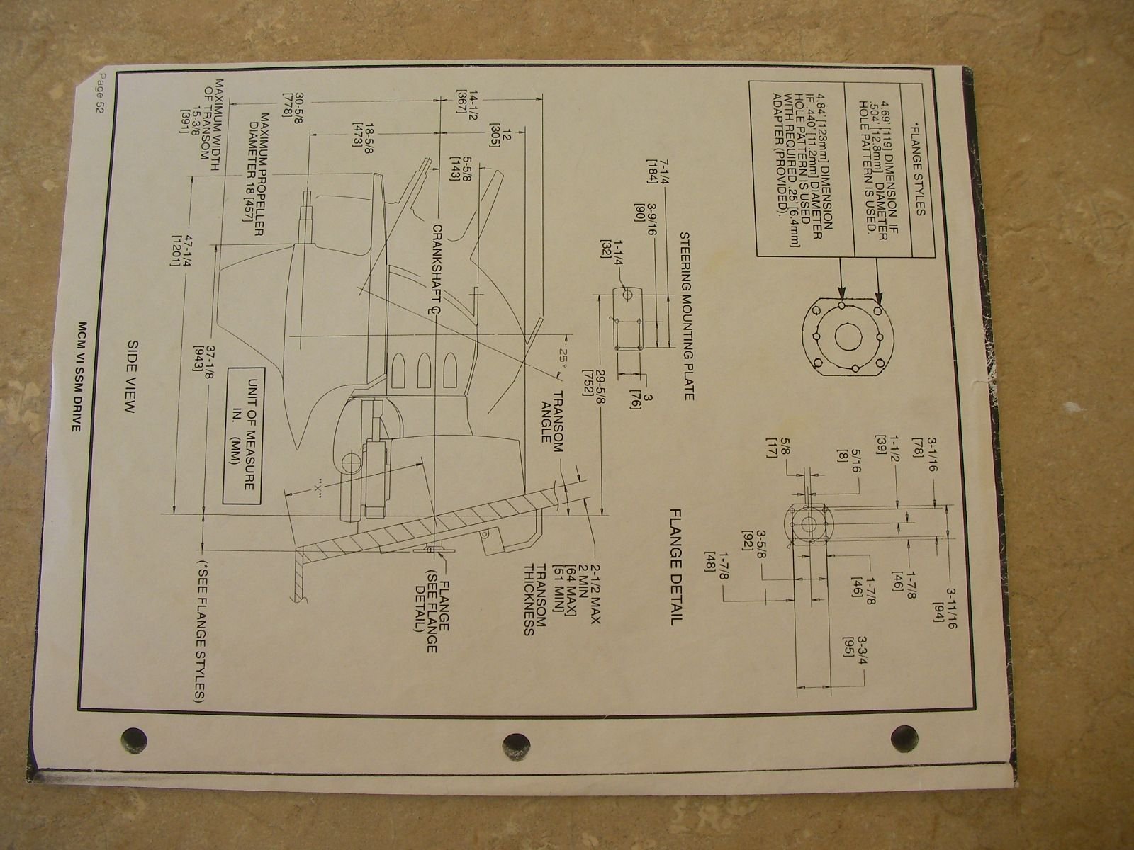

Does anyone have the measurement from the crankshaft center to prop shaft center on a #6 drive? I'm curious is this is more or less than a #4/5 drive.

book says 18 5/8 for #6, 18 11/16 for the 4 & 5
