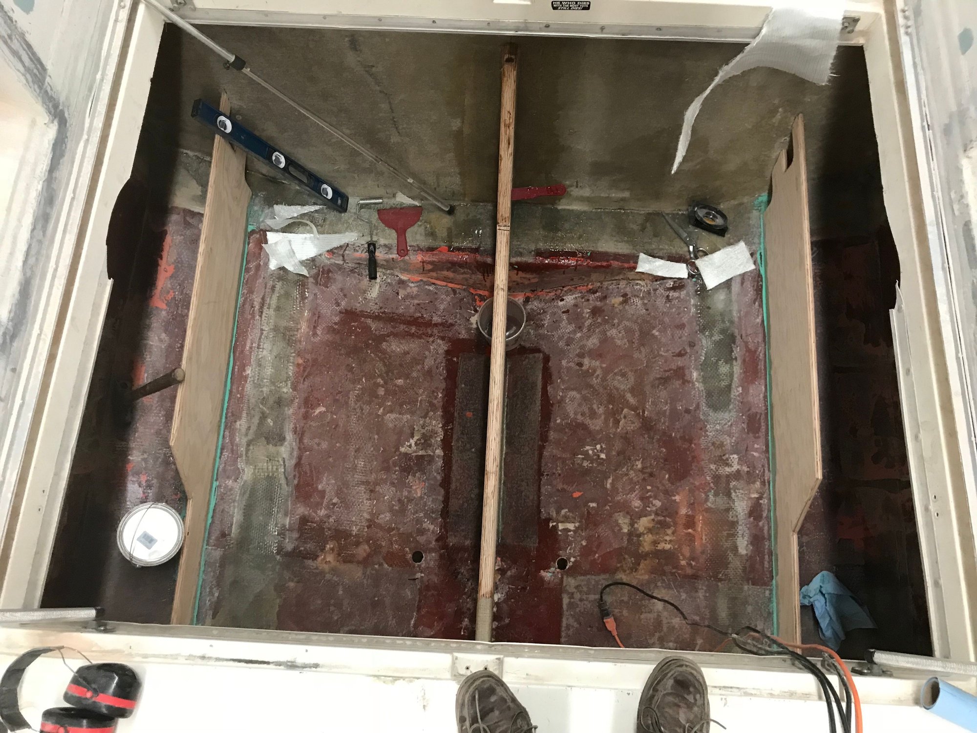

endeavour32 05-13-2018 09:51 PM
https://cimg3.ibsrv.net/gimg/www.off...ba6cd3982e.jpg
Dan-
Your correct in your assumption with filling in the notch just enough for covering the drop box. The ASD 6 on the extension box (ASD 7M) is another option, and while its not rated for the power output I have, I'm sure it could handle it. I know there are guys the have put a 1000 hp to them and they lived. It's a pretty affordable set up, a lot less than ASD 8's. What I would like to do is find a nice set of used asd 8-6's or 8-10's, and rebuild them. That is what I like about Arnesons, most of the parts that wear out are just standard automotive parts, which are cheap.
Kevin, as far as moving my engines, as you can see here, that isn't really a concern. lol.
kvogt 05-14-2018 08:17 AM

Kris, your looking at it wrong... The centers are 6" not the crank to bottom of the boat. This puts the engine usually the same as a TRS location or 1" lower than a Bravo at most. (some engines are mounted really high to get the X up but were not addressing a boat like that here)
He should be looking at our #7M Kit... If the boat is not a stagger then there is no concern for a notch issue as the notch ends on the normal 34.5-35" center line.
