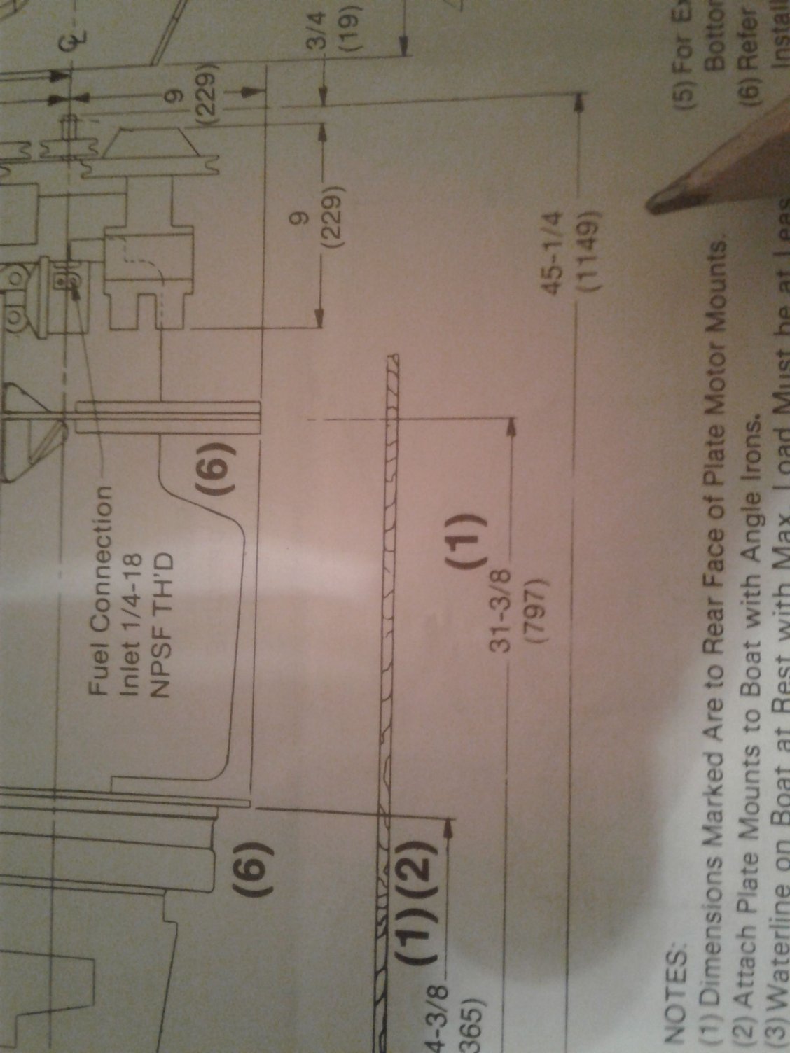

Im restoring a classic Cigarette and I need
to know the distance from transom to front of the
engine balancer/pulley.
Can someone with a SSMIII setup pls measure it for me??
any info is greatly appreciated
Thanks

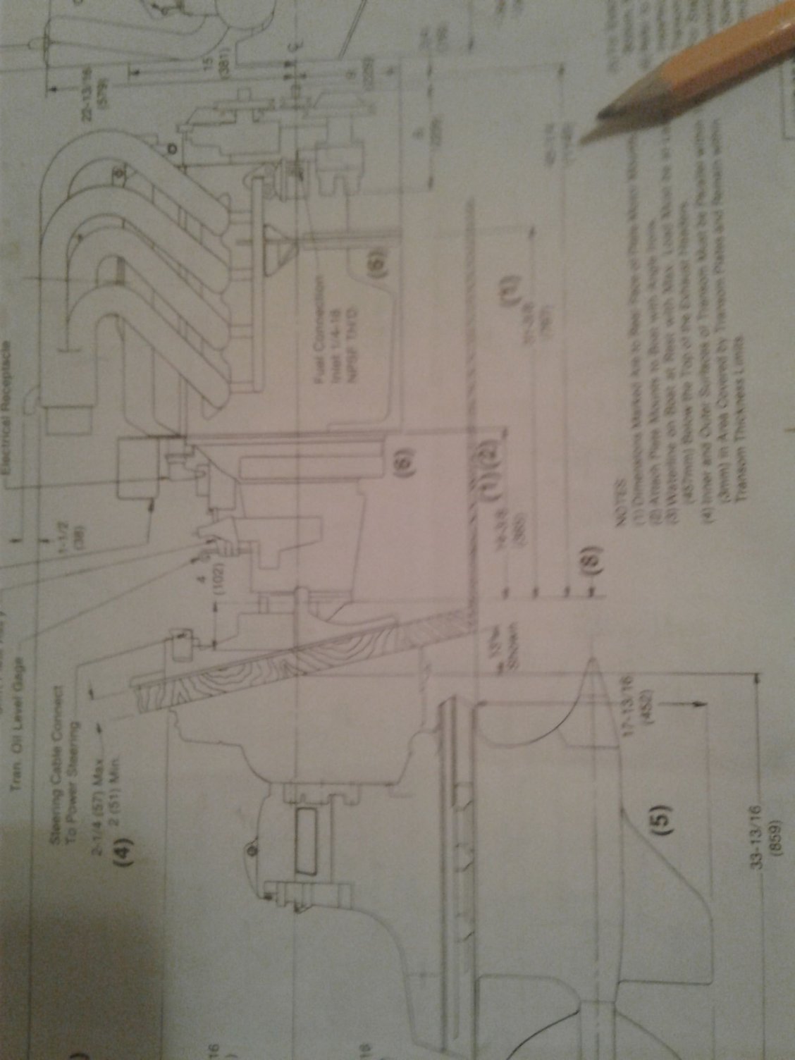

from the merc book, take it for what it's worth.
from the transom to the front of the sea pump pulley "v belt style" is 49 1/4 inches
4 from the transom to point of measure, 45 1/4 from there to the sea pump pulley.
this is w/ a #3, the dimension for the trs drive is longer by a 1/4 inch and do remember something about
there being a slight difference but by how much ? who knows.
should be able to get a better pic in the daylight, hope it helps you out

"outonsafari"
Thats just perfect and of great help !
Thanks for posting
