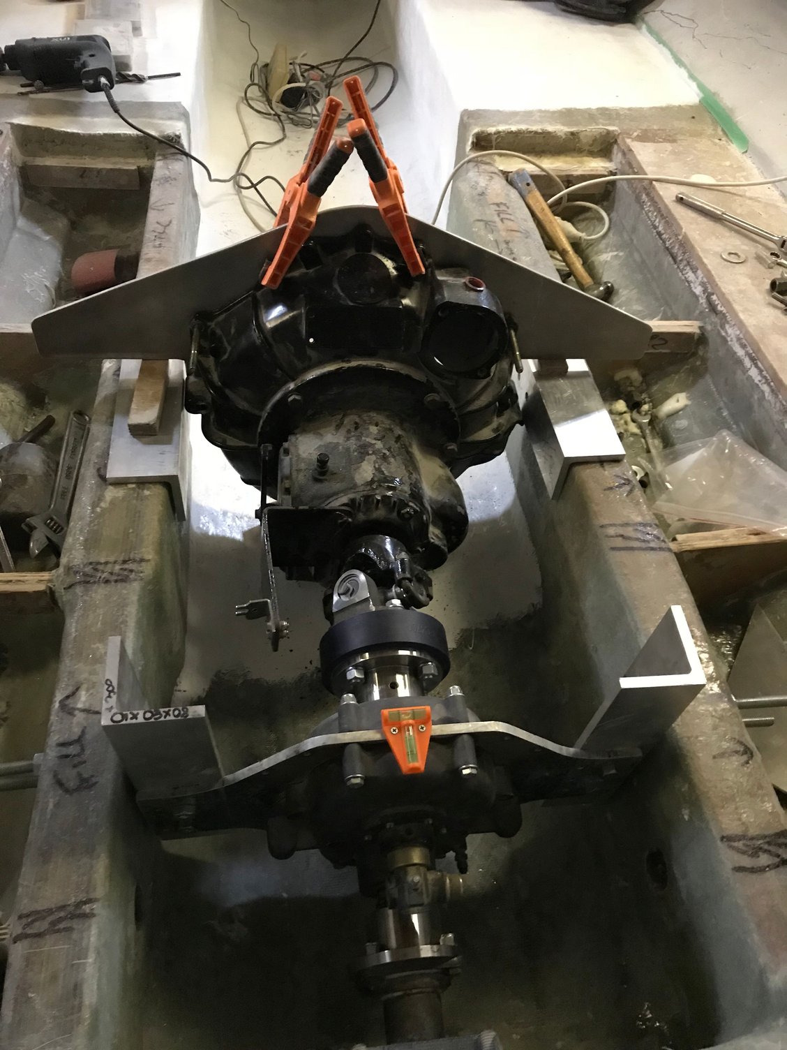

Yes conventional GM engine, bellhousing, gearbox, parallel drive, direct surface drive final prop RH
This is okder photo need to update as have the mounts all finished now
https://cimg2.ibsrv.net/gimg/www.off...b62243cc9.jpeg
Older photo

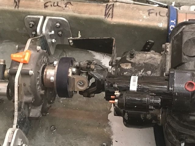

brett fiddes 09-29-2018 02:35 AM
found a more recent picture of the setup
need to upgrade my pictureshttps://cimg2.ibsrv.net/gimg/www.off...976f94e898.jpg

Ok, I see the Casale changes your rotation.
