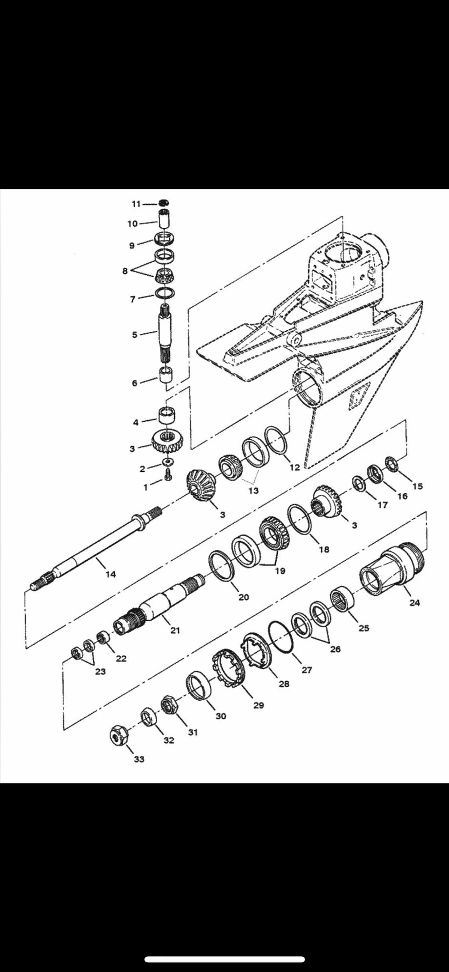

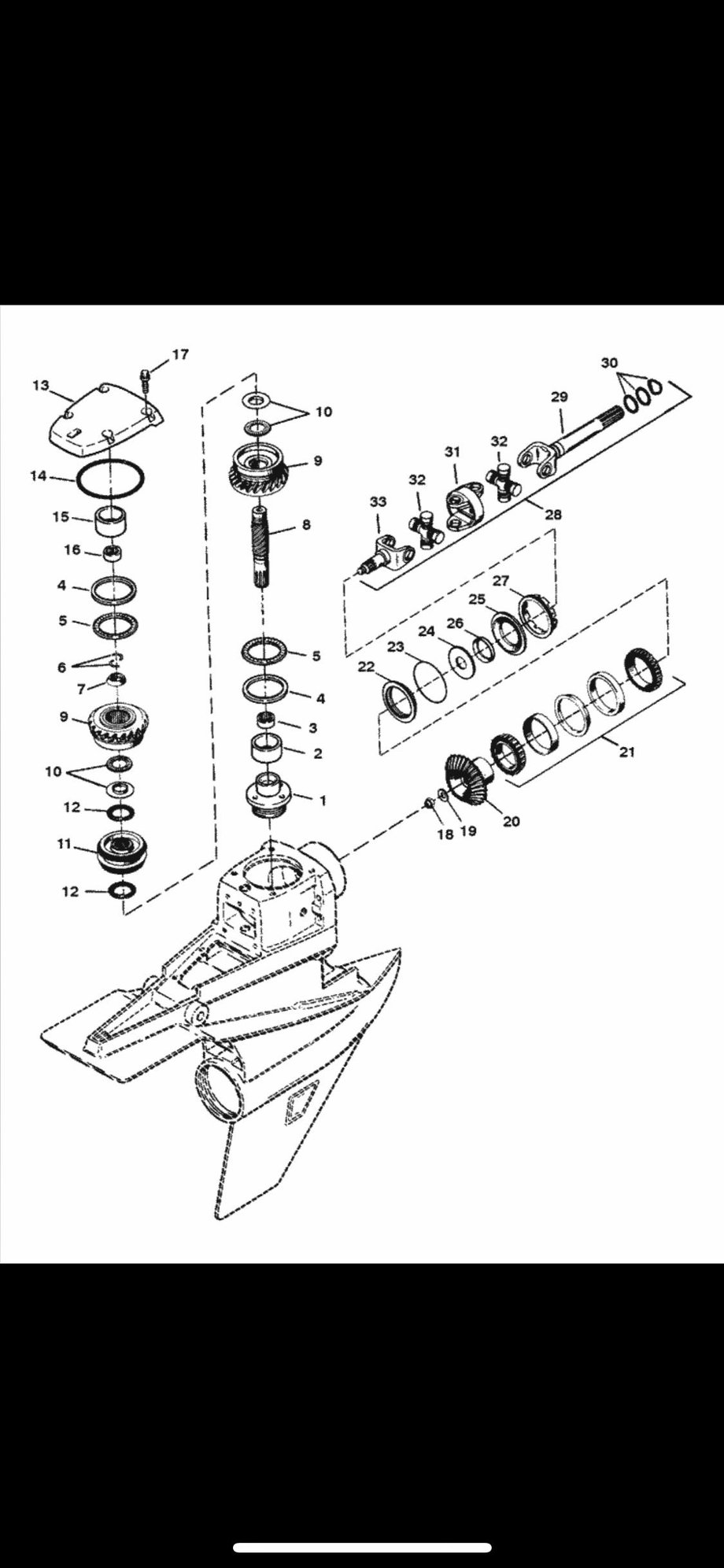

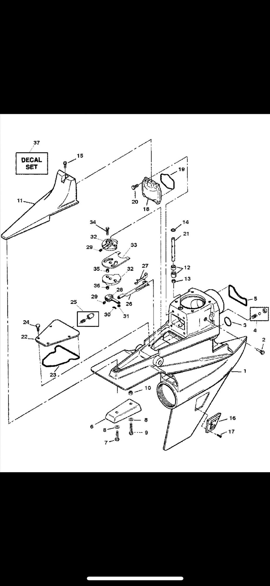

List only the number on the explode parts pics that only go to Blackhawk drives.

Is it just the case and vertical shaft that are different? Bravo 1 and 3 the parts will put one together?

No. There are a lot of parts that are "Blackhawk" specific. But, the other hard parts are Bravo 1 & 3.
The rear cover(#11), shift plate(#18), cover(#22), water inlets(#16), lower steel tower (#1), vertical driveshaft (#5), retainer(#9), bearing(#8), carrier nut(#29), tab washer(#28), carrier(#24), along with the case are Blackhawk.
All of these parts are NLA from Mercury, except for the bearing#8.
