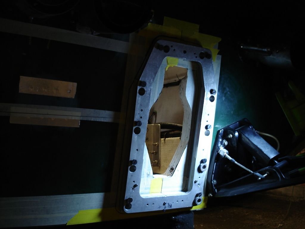

https://cimg0.ibsrv.net/gimg/www.off...153462bd41.jpg
With the jig set up you drill the transom for the studs on the extension boxes and cut out the center of the jig for the transmission .
