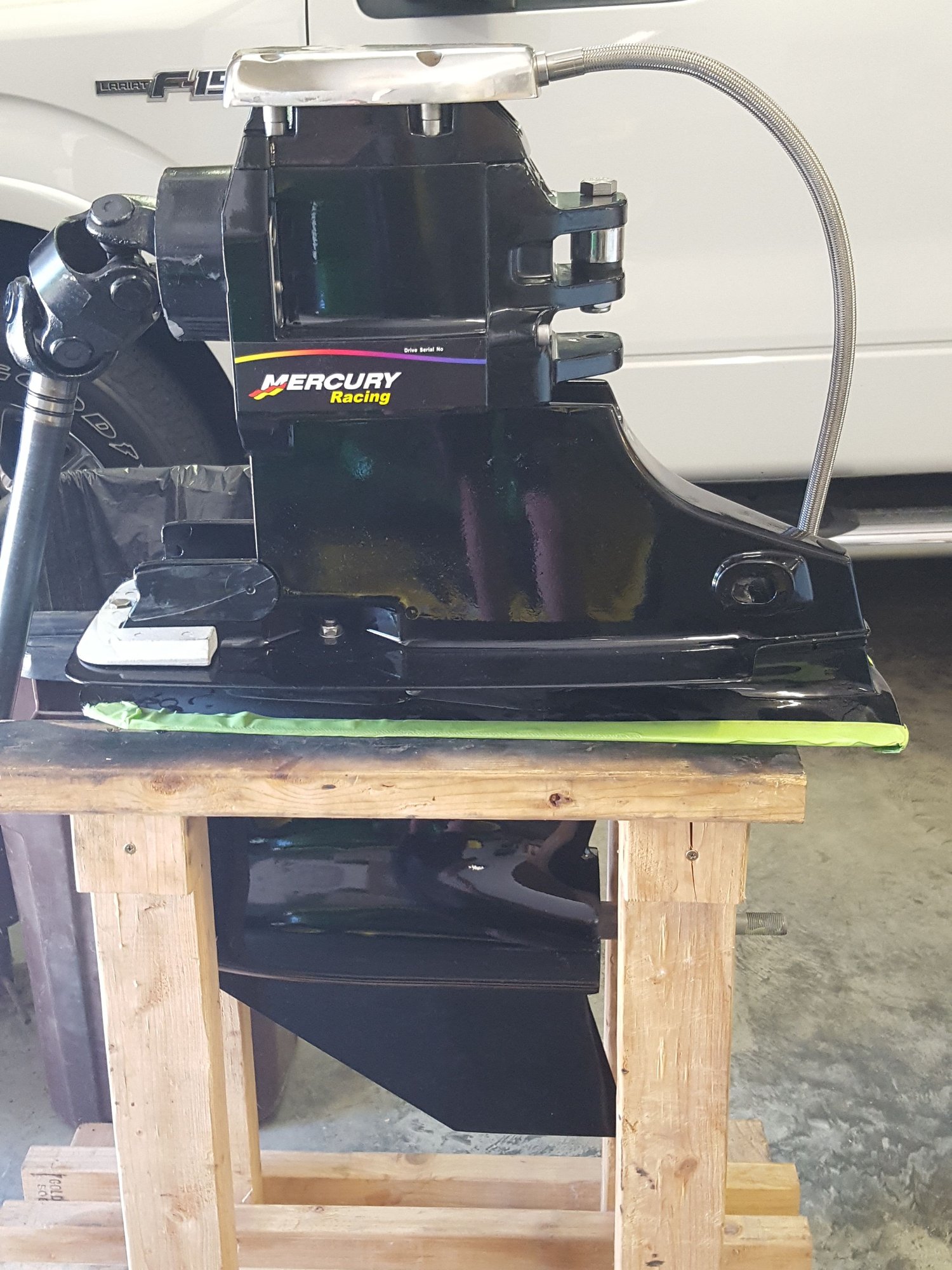

Doug @ Master Tech marine service drive specialist , he's @ LOTO.....great guy and fair priced..........run the XR gear sets
He built this one for me, they look new when done.
