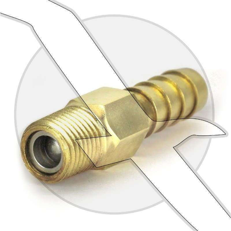

Pic below -- look dead in the middle of anti siphon valve - it was taken out and the ball dead middle was punched out or fell out upon removal - I see it all the time.
The ball bearings in a broken gimbel bearing and traveling forward is very slim as the U joint shaft is going thru the grease seal and has no opening for anything to pass thru,
think about it. .

WHOOPS THERE IT IS..........

Looks like one of the bearings in a swiveling deck seat. Also looks like it’s been there a while.
