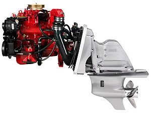

new SX came out for model year 2008 and it is a bit faster thru the water than the SX version before it. The neg is its cases are tad thinner so HP levels are not as big. Anyways Volvo themselves never put the single prop SX on anything bigger than 400 hp. They used the DP outdrive for anything 415 hp and above. the 496 HP MAG had a DP outdrive but you could get the 496 mag with either outdrive.
Volvo does not use big blocks anymore since model year 2012.
here is the newer SX 2008 to current SX

so to answer the question correctly Volvo did not use the sx for anything 415 hp and above they used the SX for all below 415 hp. So with that said there is a reason for it. They did not want it to be said their drives could not hold up per their engines. Also IMO the break away coupler is the real reason for not adapting big power to the drive from Volvo. They have a small spline break away shaft for impact damage to save the drive for a short jist
