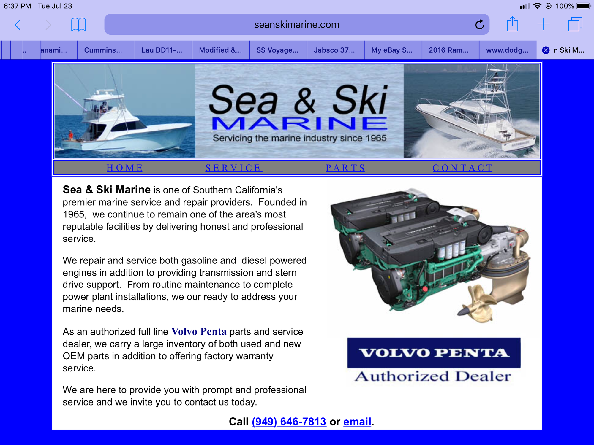

This place in Costa Mesa CA is all Volvo. He has ne w and used parts. He can keep your DPX’s alive, change ratios, props.

Yes, it was me Dom was calling on behalf of. Im needing a lower unit gear set and there are none available and have recently become obsolete. Pretty frustrating. I might have found a complete used lower but i dont want to miss another season due to somewhat minor drive issues. I will certainly be sad to lose any stability because my boat currently feels rock solid.

Thanks Cig41, ill give them a call tomorrow.
