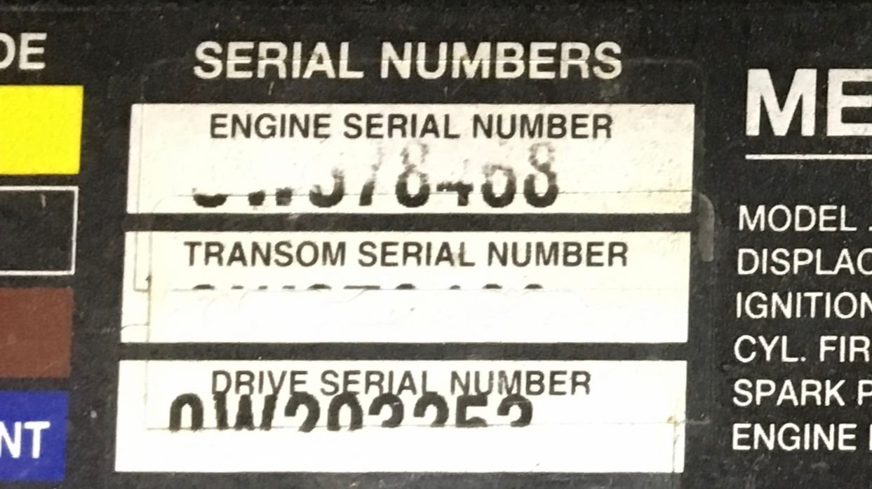

JohanSweden 05-26-2020 05:37 AM
Identify gear ratio
I found a serial number right beside the engine serial number.
https://cimg3.ibsrv.net/gimg/www.off...b1c5ff48f.jpeg
Its hard to see what number it is, but I think it is 0W293253. When I search after this number it tells me the drive is a Bravo 3 gear ratio 2:1.
Ive been told my drive is a Bravo 1 X/or XR.
With a sportmaster lower.
https://cimg8.ibsrv.net/gimg/www.off...7f4245204.jpeg
How do I calculate the gear ratio without removing the top cap and count the gears?
Is it possible to rotate the engine clockwise with forward gear and look how the prop moves, and then calculate the gear ratio?
Very thankfull for answers!
Unlimited jd 05-26-2020 07:07 AM
https://cimg0.ibsrv.net/gimg/www.off...d9fe09dea.jpeg
Looks like the serial number right here, circled.

JohanSweden 05-26-2020 08:13 AM
Theres no serial number there. Its new decals only where you can write the serial number.

F-2 Speedy 05-26-2020 08:38 AM
I dont think your 4th octet is a 9..........might be 203253 ?
