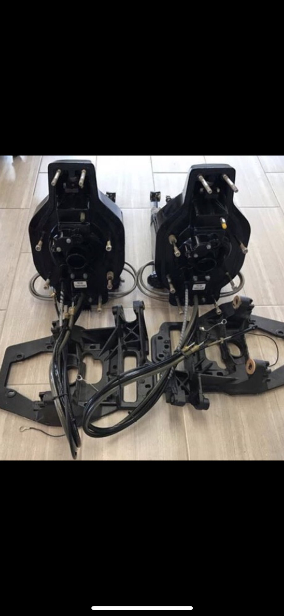

as mentioned...the steel pin is crap untreated steel. Not a 300 series. We just did our pin using the jr marine kit.
Cutting out the area for the plate is very small and not a structural issue. Thousands of boats and users have used them without issue.
here is a picture of our transom assembly. It looks brand new yet our steering pins were leaking.
1MOSES1 06-13-2020 09:52 AM
https://cimg5.ibsrv.net/gimg/www.off...5a32dba18d.png
