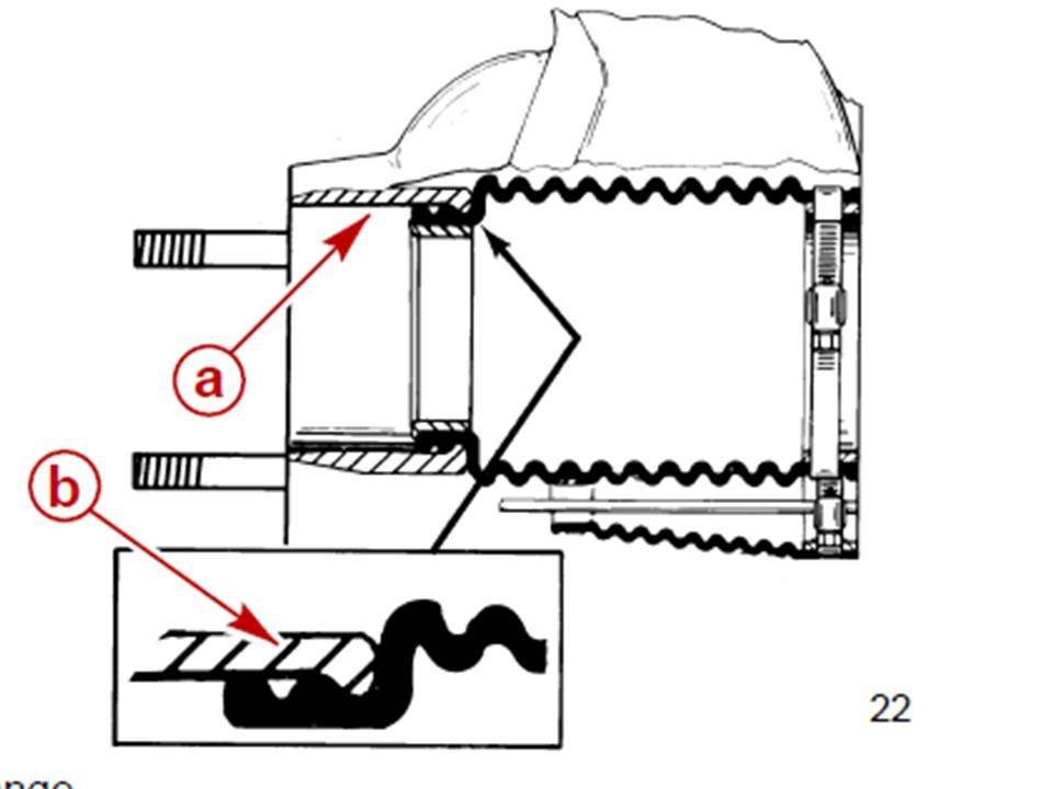

While Sierra and Merc parts are physically the same, the only issue would be if they last as long. That not being the case for your question, your double lip is as seen in the pic? If it is then something else is not right

Yes the bellow is installed the same as in the diagram, also new o rings. I took it apart again and everything is correct but still leaking. Does any body know how the dimension from upper drive mounting face to the end he of where it seals to the bellow. I am getting 52 mm there and from bellhousing mating fave to bellow seal ring is 51 3/4 mm almost 52. Which leaves .010 to .020 of an inch to makes contact and seal. I will be pulling it again to look for anything that I could of missed
