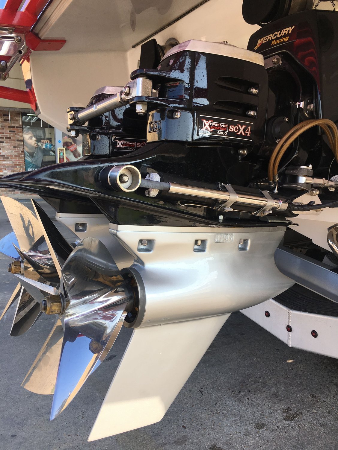

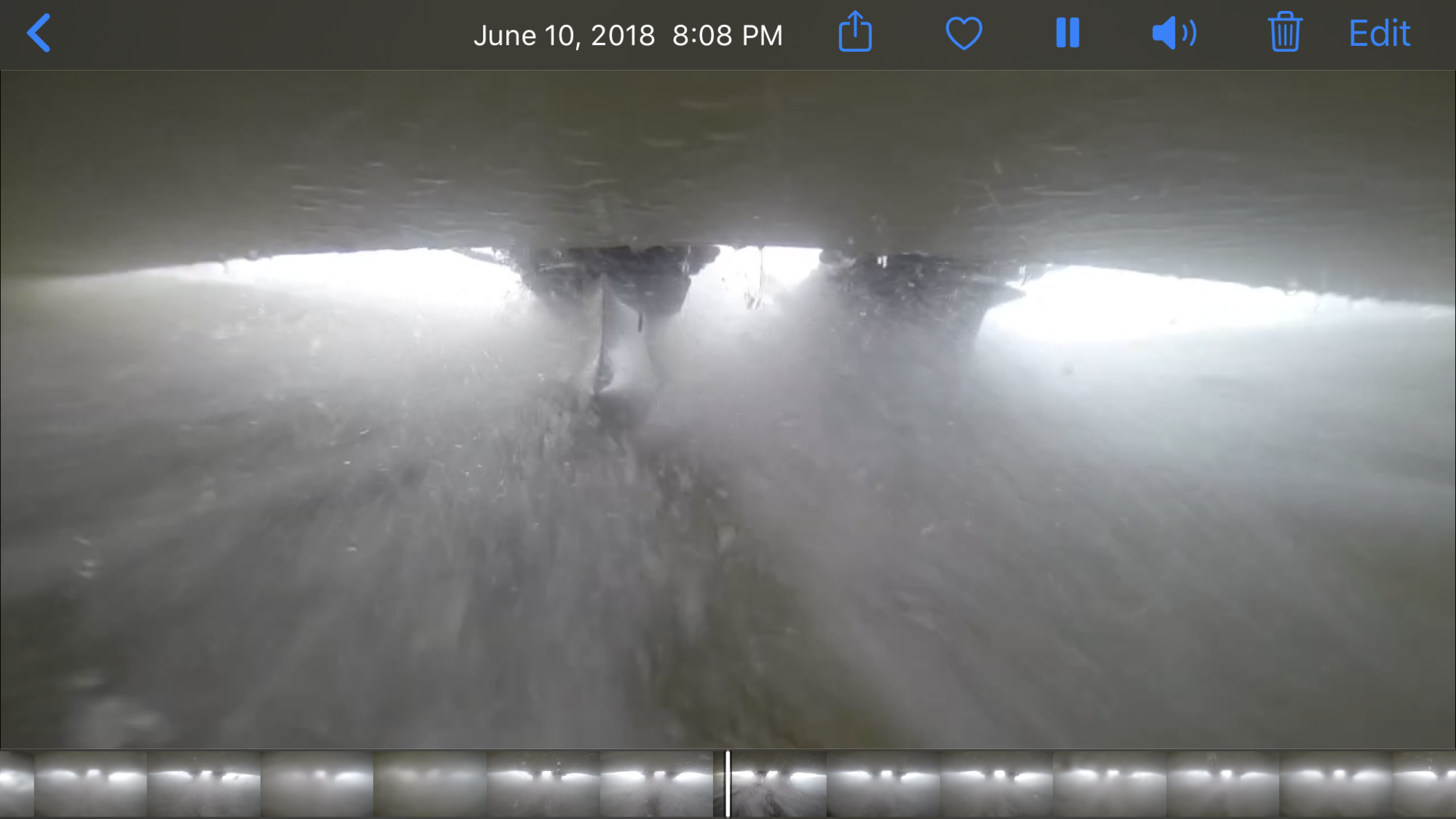

For comparison sake, my 06 38ZR imco SCX-4s are about 2” above hull bottom. Haven’t gotten a precise measurement on height or how far back they are. They are on ITS boxes. 17.25” 5 blades 18 degree rake. Planes out good with help of 280 k planes but isn’t challenging by any means. In a video that was taken with a go pro mounted in the notch you can clearly see the tip of the lower above the water. My slip isn’t the greatest however, 15-18 percent at cruise. From my experience and shops I’ve talked to the big imcos run the beat when up high out of the water and have a 16”+ cleaver to get around the big bullet and reach the water. There’s also the handling advantage with the cleavers. My boat was set up high to begin with with long sportmasters. 100+ 4 people coolers, full of fuel. 105 light, best so far of 108

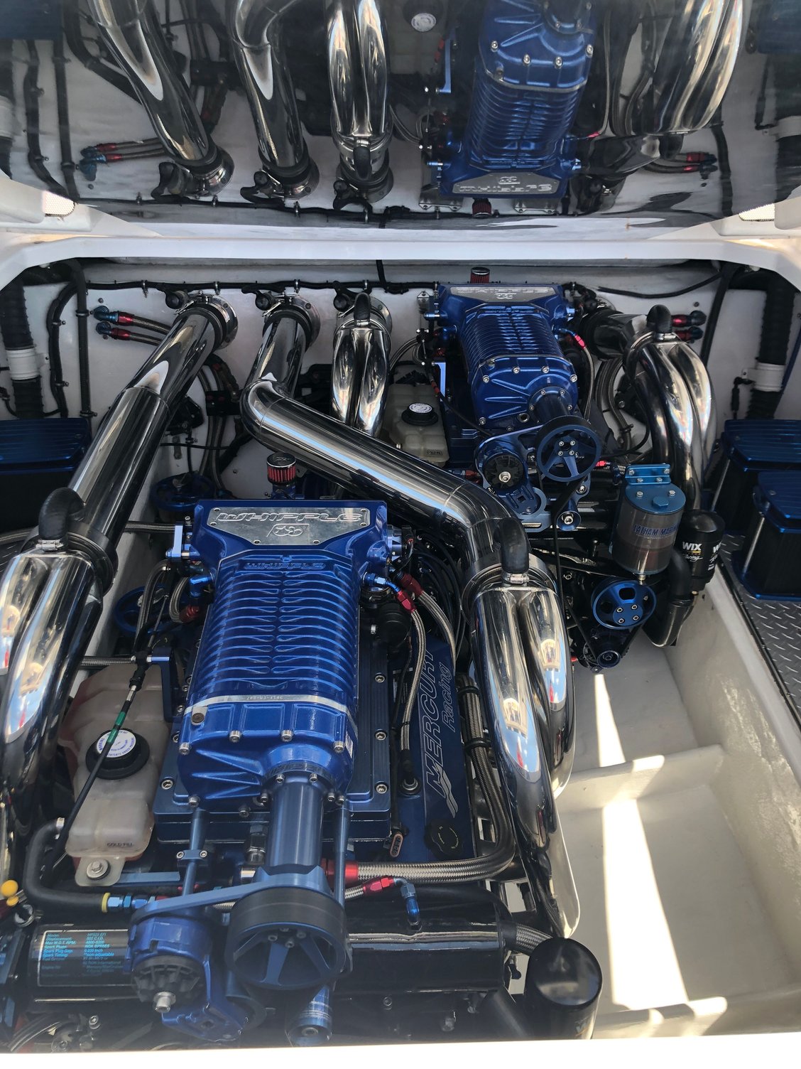

What engines are in your Donzi? Are they Whippled 525's?

Yes whippled 525s. Valve train obviously redone but other than that they’re still 525 guts. Boos did the tuning, run a 4.5” pulley, never on the dyno but should be around 825hp. Imo the whippled 525 is a really good package. A guy can’t help but think what it’d do with NXTs or #6s. The imcos are power/speed suckers but like others say you’ll be out boating not on the trailer!

Endeavour, I measured my friends drive height. 2007 39 TG 700s with NXTs 17x35s and his drives are 1 inch above bottom straight ahead of drive. Hopefully this can help you?
