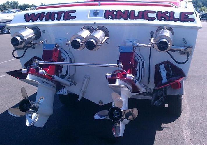

Use an epoxy primer and urethane paint. I used single stage PPG. (not acrylic urethane, or urethane enamel)
The first pic is 2010 last pic was 2020. Only paint missing is where it wore off the skegs from beaching. No chipping or peeling
Post 10 will show what I started with. Pitts were filled with Dynatron Dyna-Delite.
Scarab Panther always a work in progress
2010
2020

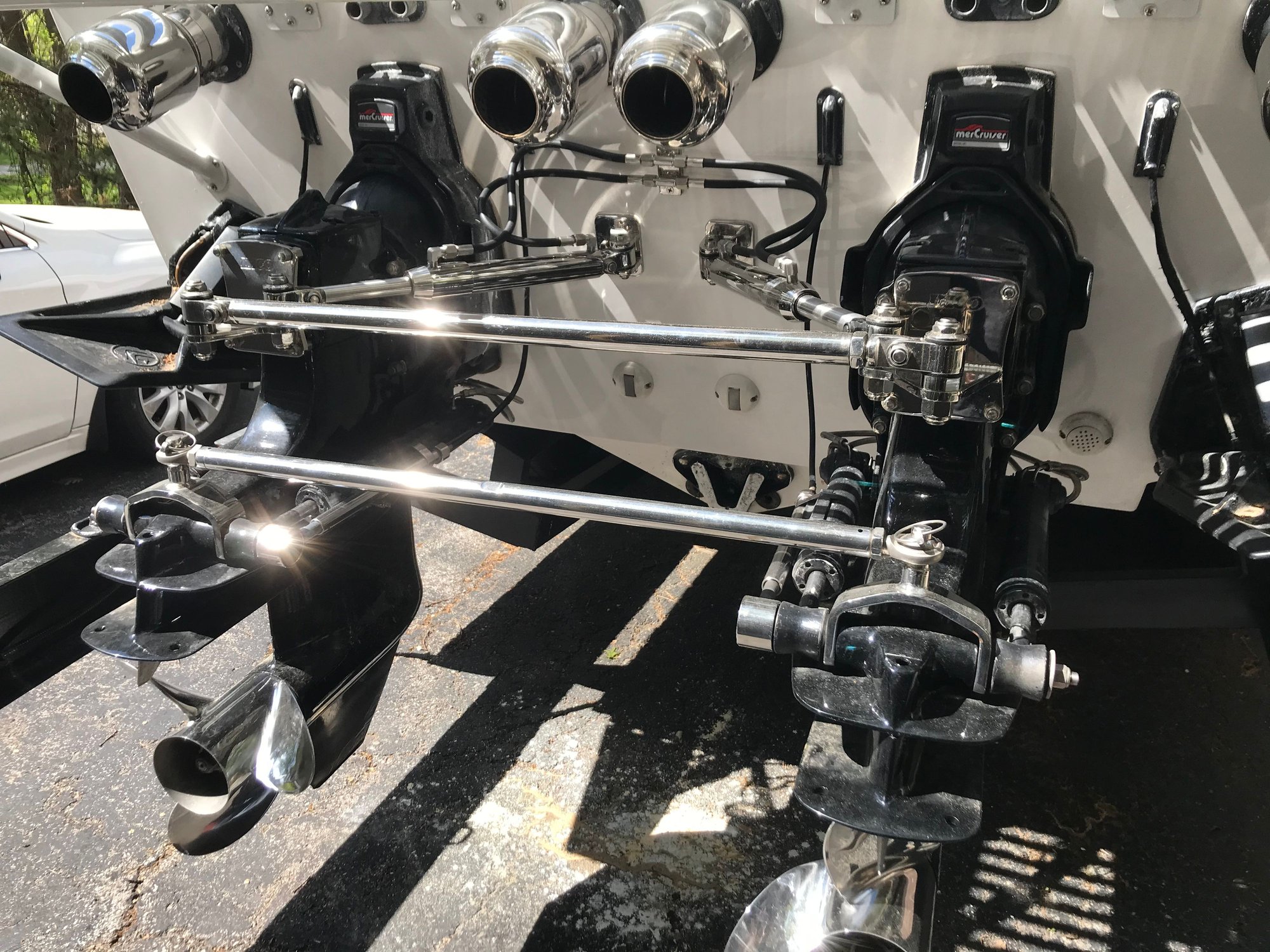

I have painted many drives, what usually works for me is to sandblast the unit first, then use a good metal prep made for aluminum. Prime the units with either a good epoxy or chromate primer. I usually use a good single stage automotive black. As others suggested also make sure your anodes are correct for the type of water your boat sits in. Salt and fresh have different ones. As Craney suggested they do make a two part spray in a can, you can order it through Eastwick with other two part primers and clear if you do not have access to spray equipment. It also never hurts to keep them clean by wiping them down from time to time when you are at the beach. Good luck, hope it helps.
This bottom one was taken right after it was out of storage for winter so they look dusty.
