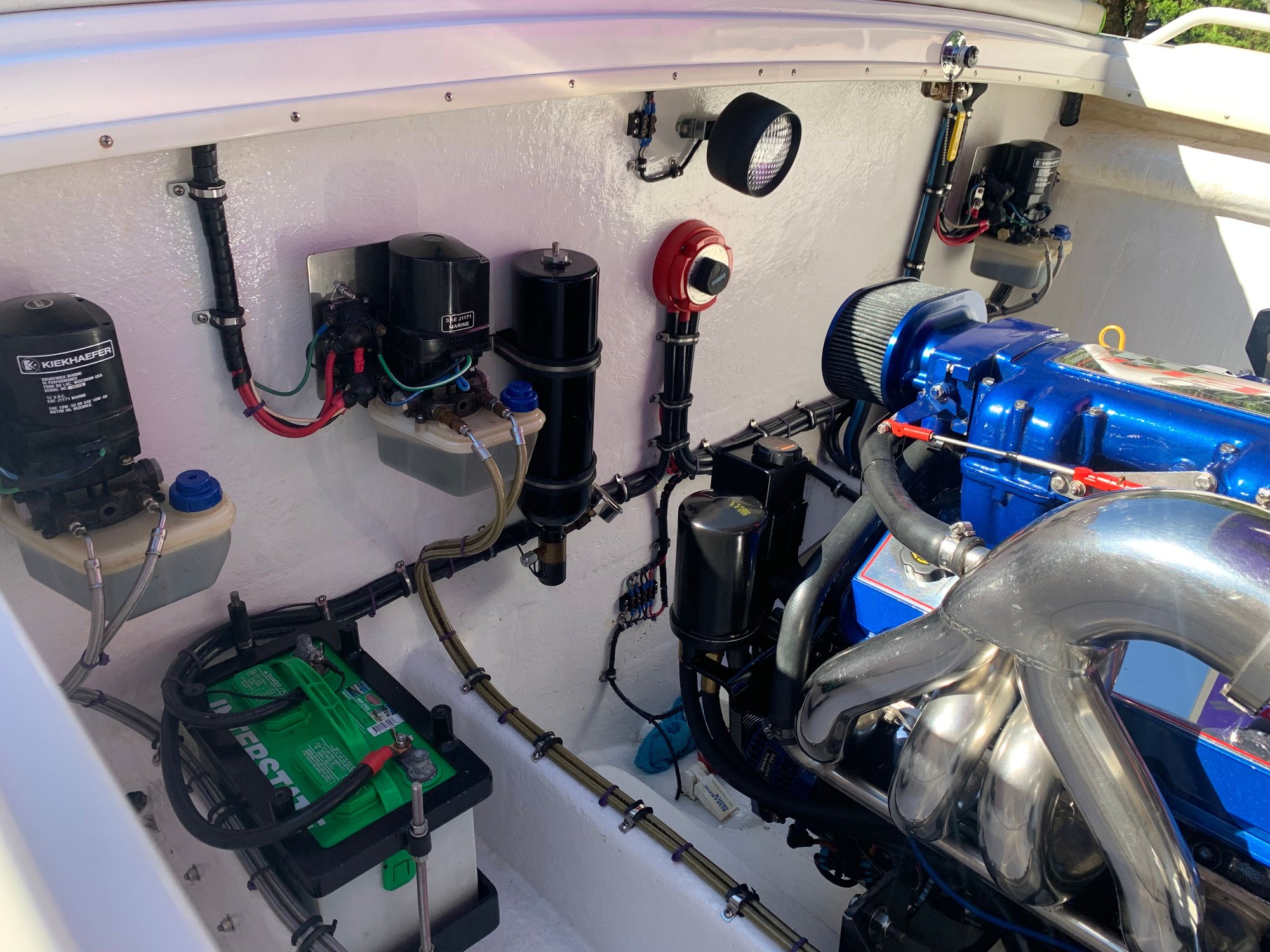

I have 500EFI that Jason at MDG built brand new. It’s a dart block 532ci - 545Hp 620 ft lbs. but I want to increase the power in the next couple years. Maybe whipple or some other option. I figure, upgrade the drive and get some money for the bravo one, then get the blower or something else for more power. But an SCX with the mild power I have now is a pretty reliable package (or at least I think that)
Nice.very clean. Is that hose along your stringer a flush hose? If so is that just a tee or is there some sort of back flow preventer to keep the water from just running out the drive? Curious because I have to make up some sort of flush setup for mine

It is just a T. Jason used the Teague marine flush kit. If you look at the top right of the picture, the hose comes to a ball valve that is closed with the handle pointed down, then comes out of the fiber glass right above. Seems to work well and the placement is easy to use.

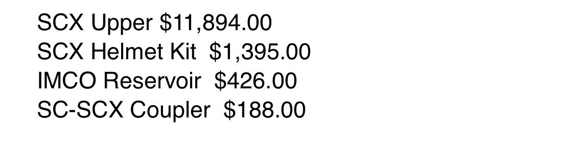

Forgot to add - if I go SCX upper, I am going to use a XR lower

You probably know already but new drive reservoirs are needed also for SCX

I came up with the list below. Missing anything?
