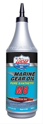

I used Lucas M8 synthetic gear oil and never had an issue. Like others mentioned there will always be opinions on everything out there from wax to oil to filters etc.
