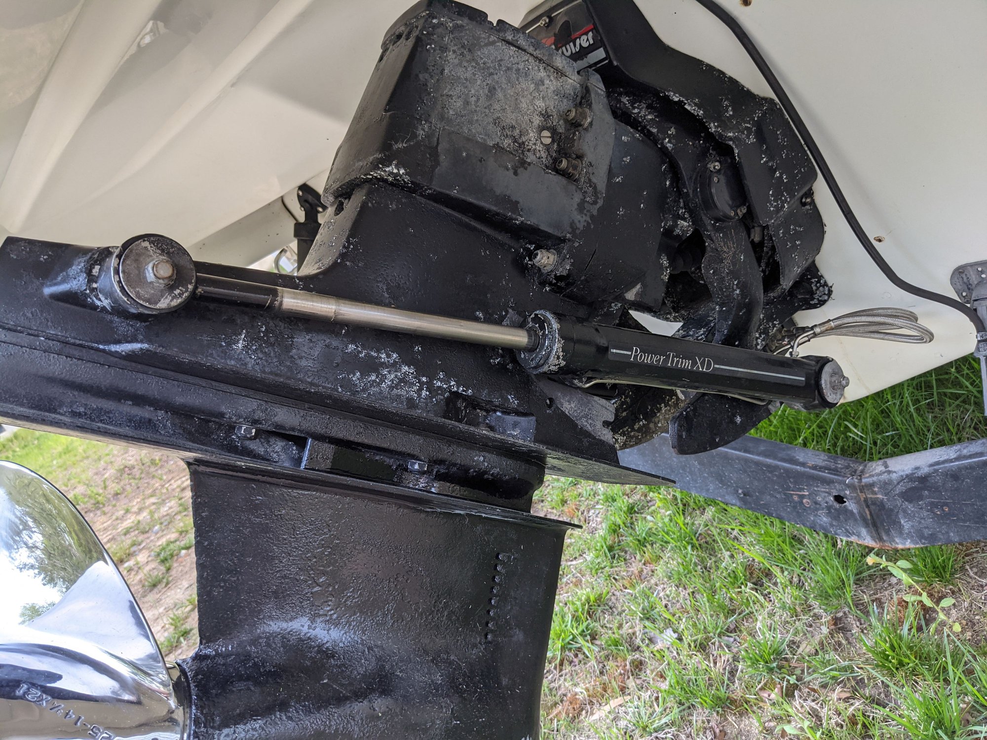

So came.by the trailer the other day and noticed the drive had completely lowered itself after being in the trailer for several days. Goes up and down without an issue. No fluid leaks anywhere.
I'm guessing it's either a valve in the pump or a seal in the Rams on the drive. With no leaks, is there any way to tell which it is? The trim pump looks like it was replaced (albeit with a used one) according to the paperwork I have in fall of 2020. The drive rams are the original 88 drive rams it looks like.

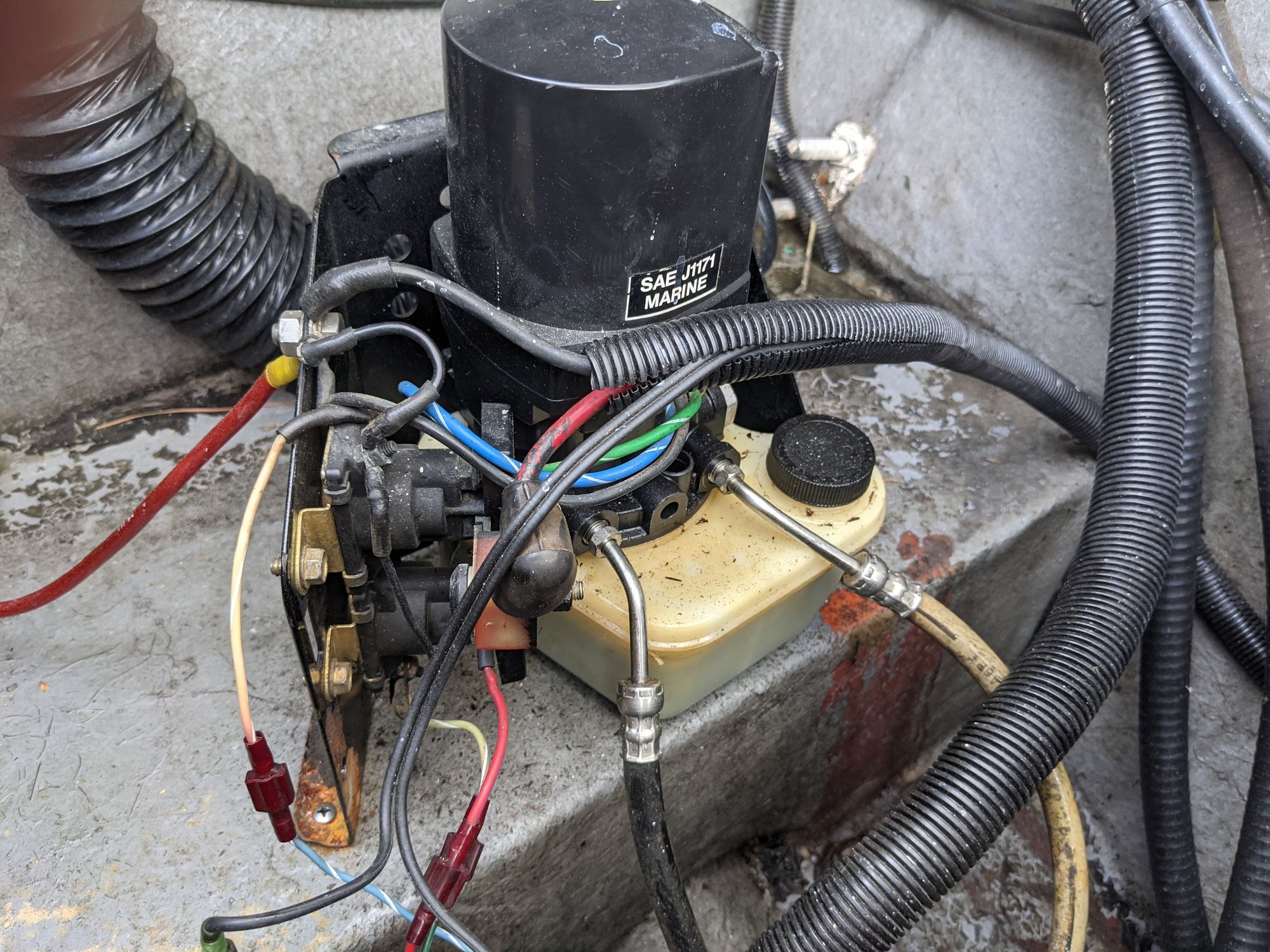

You can rig up fittings and a pressure gauges and run those lines from pump to the fittings. This will test pump, should build high pressure, I think 1000ish and hold it. You will quickly notice the pressure drop if a pump problem.
But to be frank, I’d put money on the pump. Just replace the pump and reservoir together.
ive also seen the reservoir just have a mere crack in it such that the pump drew in some air with the fluid and caused drive to drop.
Go2marine is the website and pickup at API unit. Think it’s under 200. Should be good to go.

Would this be what your talking about? I thought you had to replace the whole unit.
https://www.go2marine.com/Hydraulic-...-Flow-Gear-Set
Current unit:

Saw it on another thread here, but wouldn't an easy way to test the rams be to trim the drive all the way up and then pull the hoses off the pump and cap them off? If the drive doesn't drop, it'll be obvious it was on the pump end? Just a thought.

Had this problem with a B1 on our last boat. The root cause ended up being the reversing piston in the pump housing, that had been scored by some debris. It was allowing bleed-by and the drive would drop while cruising down the lake or on the trailer. The boat came with a couple of ram locks that would keep the drive up on the trailer, but obviously didn't solve the issue while running. We ended up having the pump repaired while the gimbal assembly was being rebuilt. The guy replaced the reversing piston with one he cannibalized from a scrapped pump he had laying around, and the problem went away.
Something to look into.
