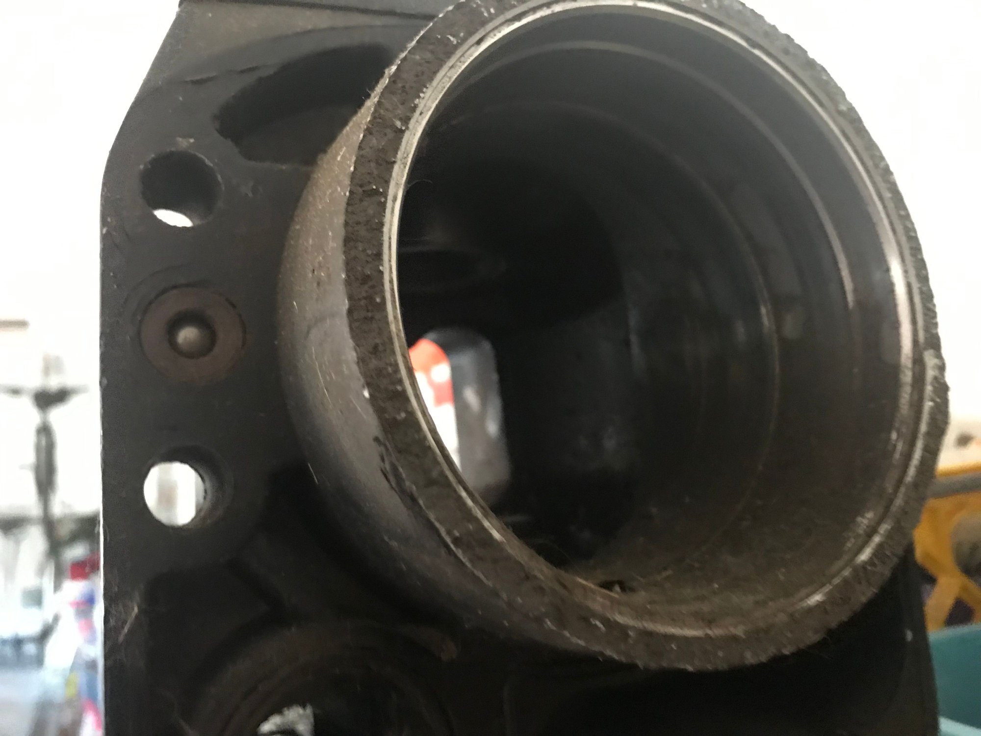

The weak link is the XR upper gears, the’ll chunk out or in some cases,
break a tooth off and that loose tooth will try to make its way between
the drive and driven gears, then something has to move to allow that to
happen, and it’s generally the case snout right behind the pinion retainer nut, when that happens, you’re replacing the upper.

This is the end result of a tooth breaking off

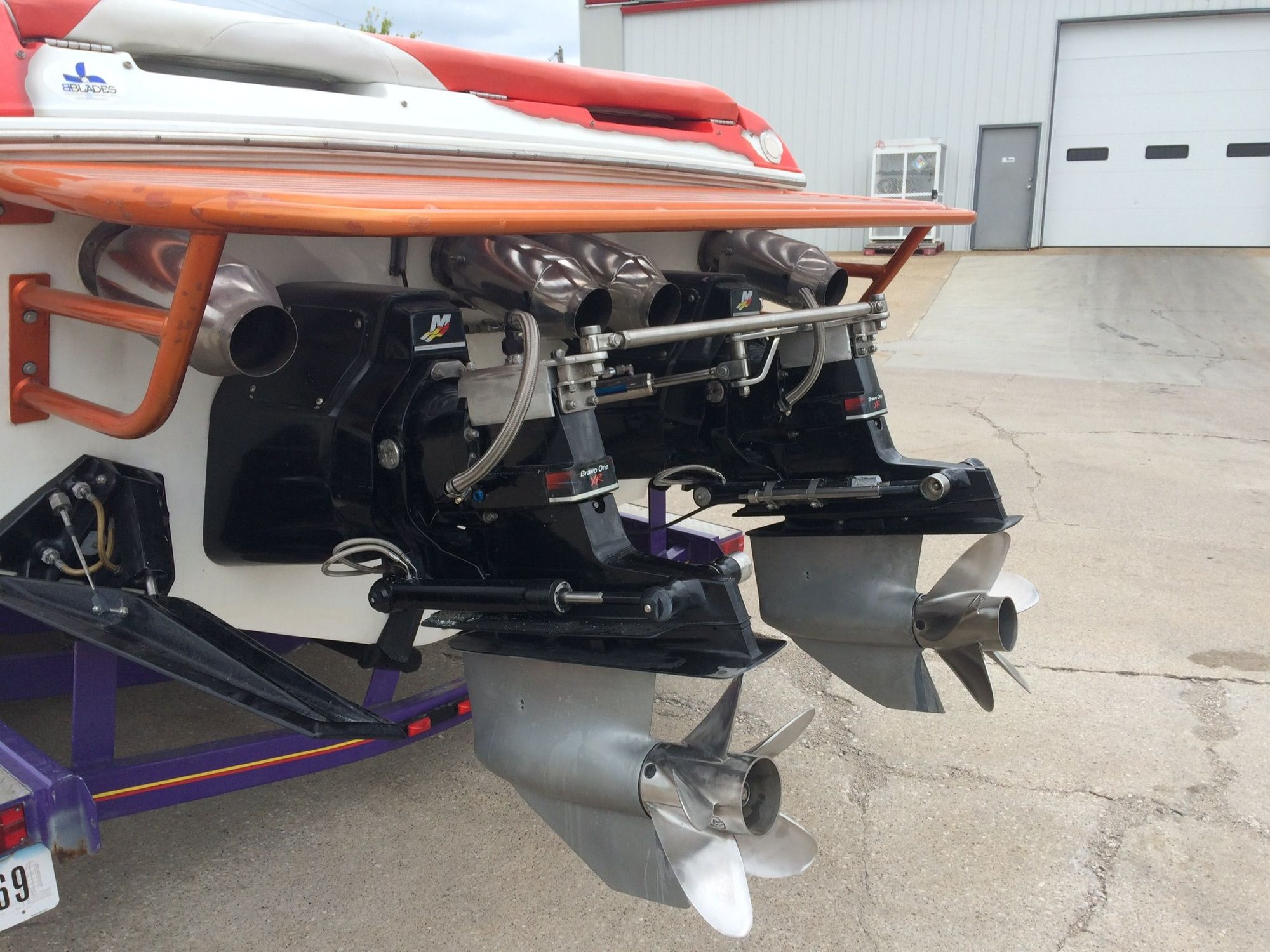

Indeed and thanks. The short term plan, is just to refresh and with some inexpensive upgrades, get to a reliable 500hp to the props. The drive upgrades are for right now reliability, and for future serious upgrade in power. The boat is awesome, and in immaculate condition, I can see spending most of my discretionary income on it in the future. I am done with hot rods and hot bikes, but still have the need for speed. Low 90's on an occasional glory run, and around 85 with a weekend load out would satiate the thirst. Sometimes just knowing that you have it, is half the fun. I hear that Baja's are not made for that kind of speed, and I wonder why that is the consensus. At 82 that boat felt tight, and stable and I did not have any of the huge Kplanes in the water. It felt like it wanted more. I do have a B1 drive that I blew the upper gears out, when I was trying to push my 272 to speeds it wasnt designed for lol. maybe I should have learned from that huge expensive mistake. The 272 now has a brand new B1 and a very reliable 468. It will be for sale soon to help this new boat along. The damaged drive is rebuildable, and I have been holding off to see what I decide on the drive choice for the 342. After looking at SCX and Bmax total pricing, it is looking more and more like blowers are not in my future. I may not be in the right tax bracket for twins at that level.
