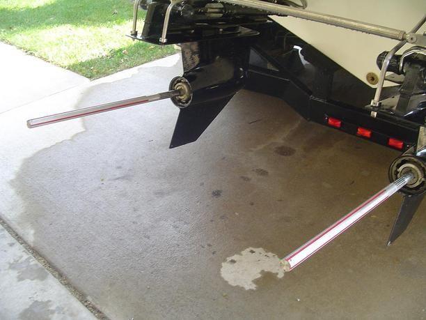

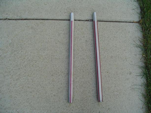

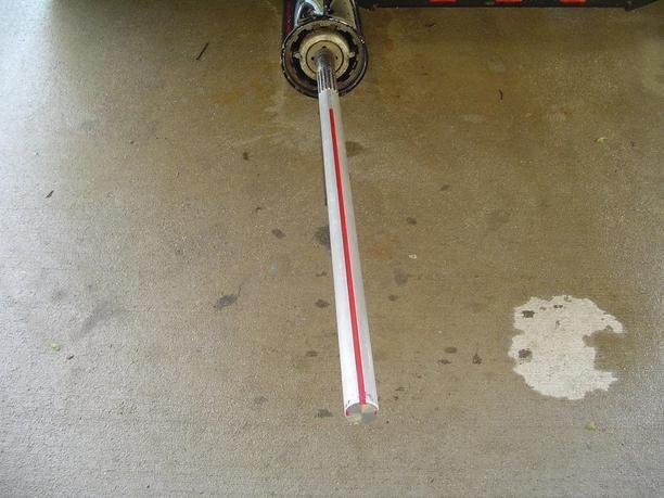

A number of years back i made myself these alignment bars. You thread them on the prop shafts and just measure from front to back. Then you know they are dead parallel and can measure the nose cones and adjust +/- easily
