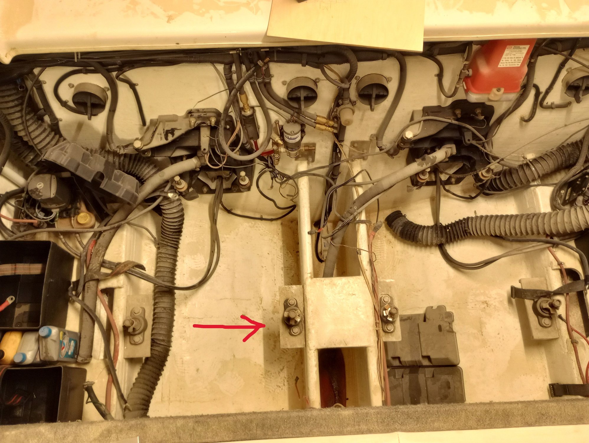

I had my transom and 3 stringers redone and when they installed the starboard engine the one front mount didn't line up so they elongated the hole. You can see that the one mount is turned a little.

I have some leeway to move the front mounts, but the rears won’t allow the front to move enough to make any noticeable change.
