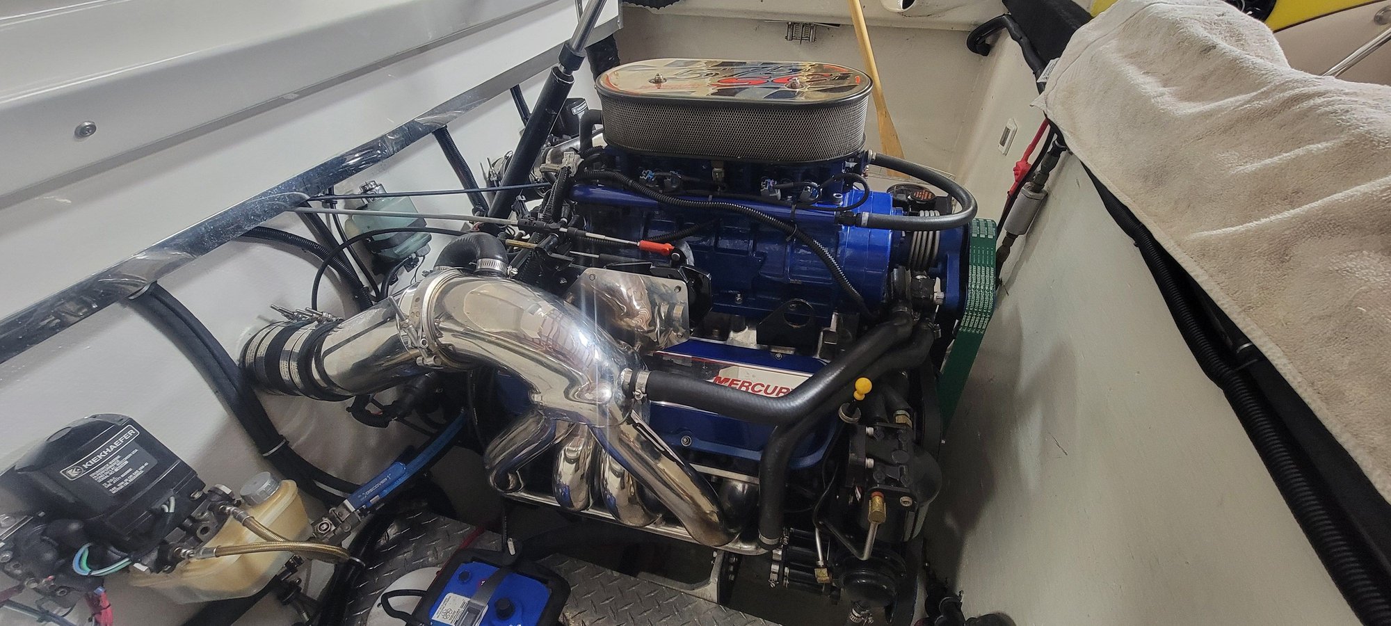

got the dual steering finally done and got her all cleaned up. She is so clean for 22 years old
hpmaniac is offline

Looks good! What steering was on it? I like the pipe swim platform. .most 280s have a added on glass platform.
Padraig
Padraig is offline

Not sure on platform, I've never seen a 280 with one like it. I remember some 260 boats had them. The boat only has 344 hrs, 112 on the 575. Such a sweetheart.
hpmaniac is offline
