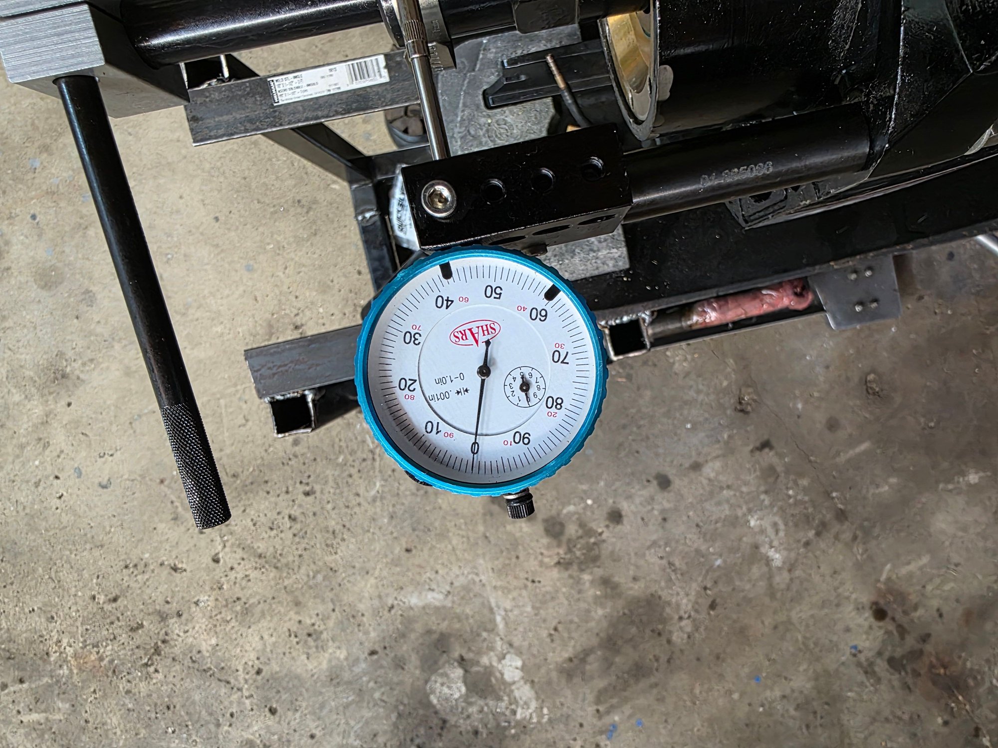

B3, has about 83 hours total time. changed ratio from 2.0 to 2.20, new upper gearset, new pinion bearings. Set up driven gear with tool-had to reshim to get proper depth. Checked lash-.019 on both fwd and reverse, new races so both fwd and reverse are now.014 lash. Driven gears, - and + ticks directly above one another. Fully assembled, filled with lube and noticed that when turning the input shaft, I have a very tight spot in reverse, but loose enough that i can turn it over by hand. I marked the universal to see where it was and it affects about 20 degrees about every 1.5 revolutions. Forward and neutral are butter smooth. Lash feels good even in the tight area. I have now taken it completely apart 4x and cant find the tight spot on the bearings, races, thrust bearings.
What could this be?
