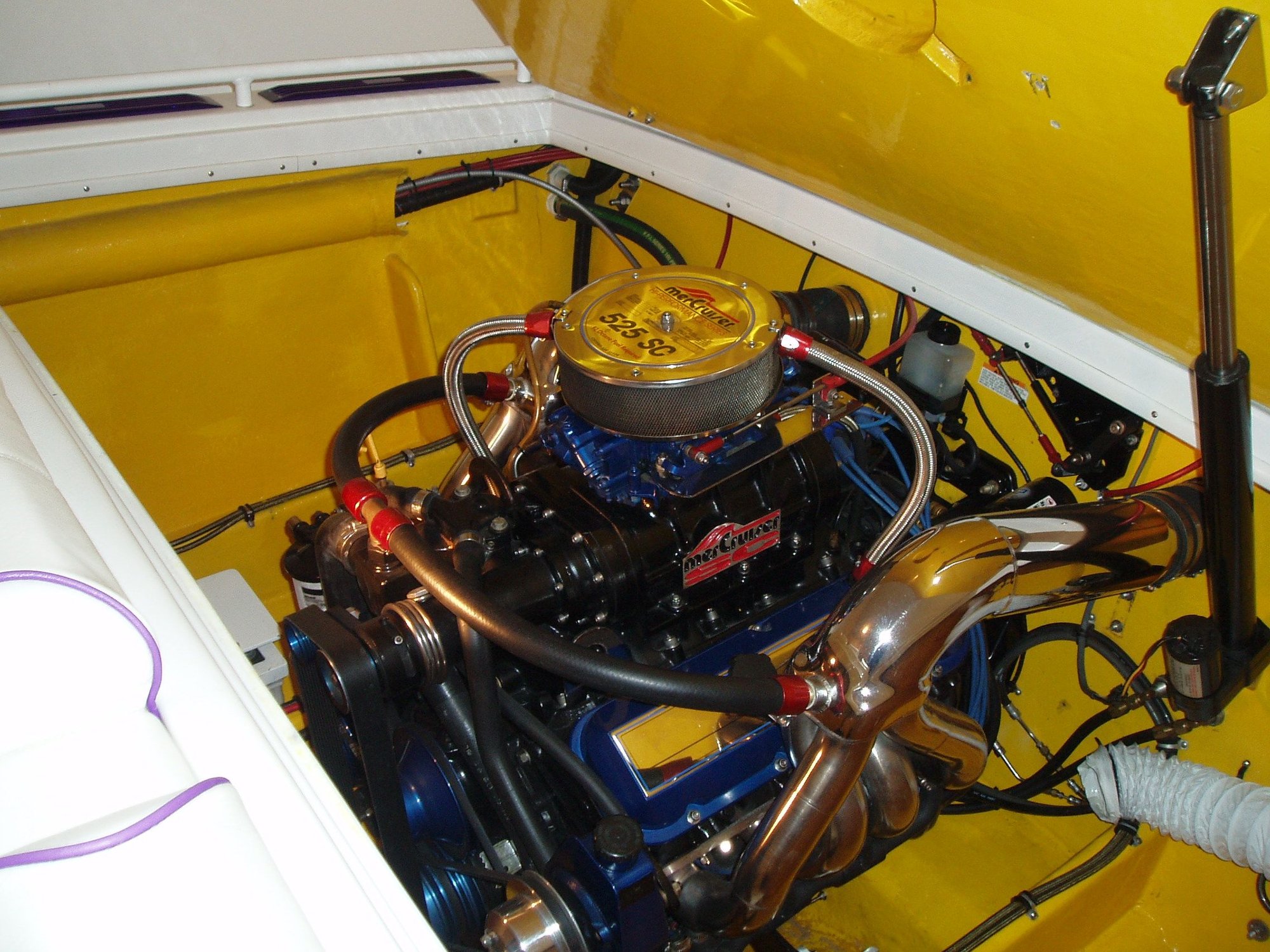

I've been outside looking at it since my last post and had pretty much decided to build an extension bracket to bolt on the stock exhaust location and give me the 6-8" needed. I may still do something like that to keep it out of my bilge (Im adding a bulkhead behind the engine in an attempt to keep it dry and salt free), but I may go with your suggestion for simplicity. God knows I make a lot of simple things much harder than they need to be
Thank you for the picture and recommendation. Ill probably take it!

I did something very similar. I put it on my transom and just let the cable length(s) be the final placement criteria. I didn't have to change or modify any cables.
Thanks. Brad.

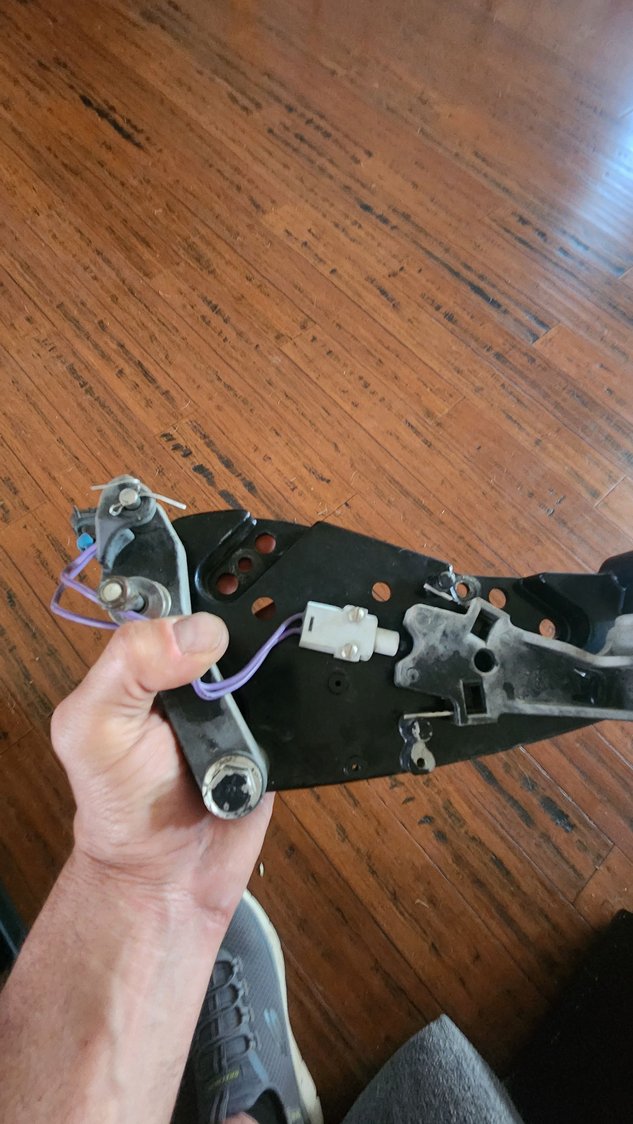

Research indicates that is a shift interruptor switch (or one of the variants used in Alpha drives and MPI engines), a relic from the MPI/Alpha combo that I acquired it with.
Research further indicates that Bravo drives do not require a shift interrupter switch, but MPI engines use an alternative to inform the PCM.
It seems that Bravo applications with carbed engines use no switch (besides an optional neutral indicator to kill the key start position).
That, and the overall simplicity of the carbed/bravo combo is pushing me toward a carb rebuild/replacement.
Can anyone confirm that the above is all an accurate understanding?
