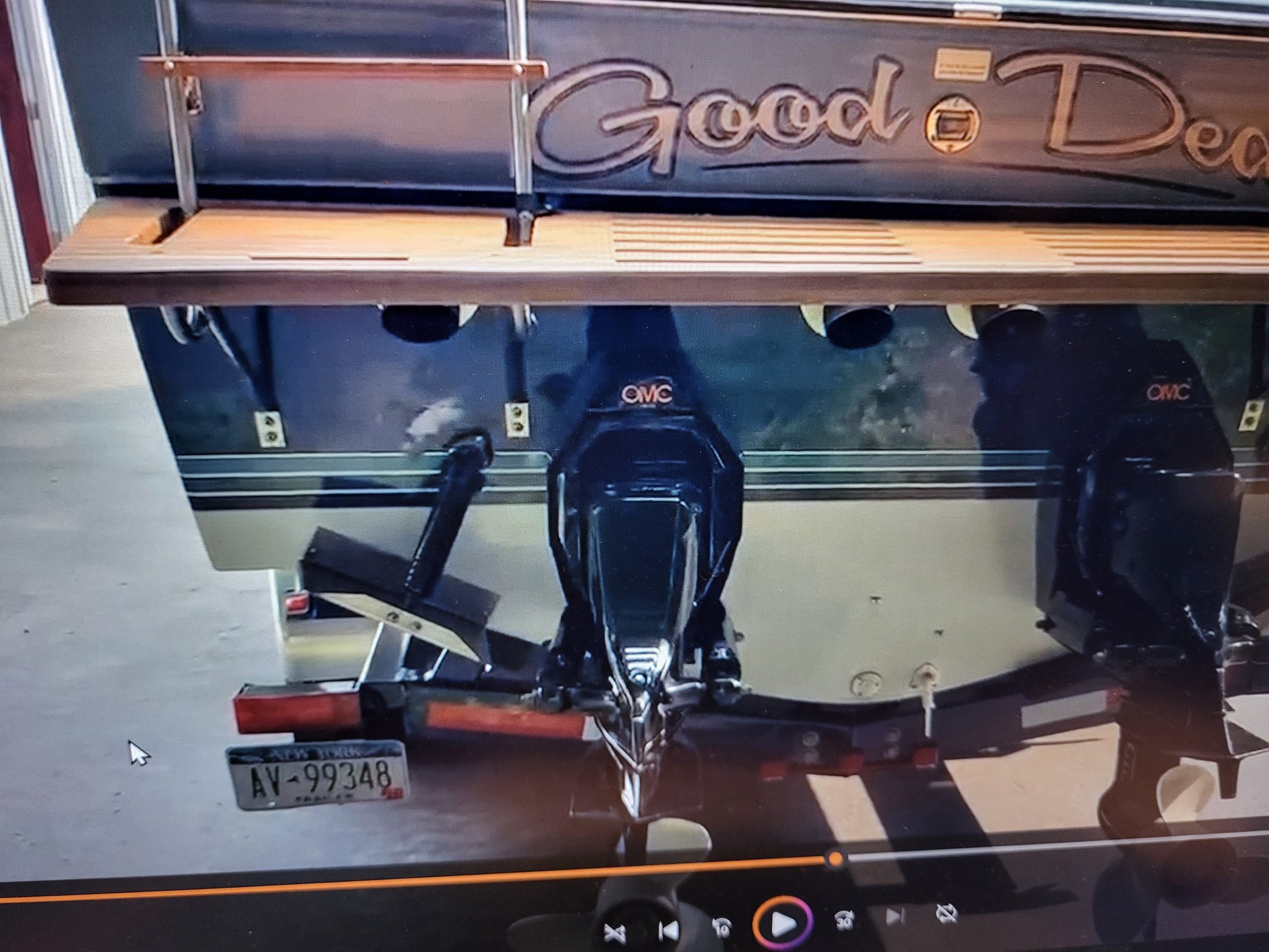

So I need to find out more about Thru prop exhaust or other options to keep the noise down! Are there other options maybe less expensive to quiet things down? I watched a youtube and the person had a Formula with an underwater exhaust option?
So far every boat in the style I am looking at has had thru hull exhaust. Usually a 350 or 454 engine, most boats have had Bravo 3 outdrives, a couple had 1's. What exactly is needed to convert on of these to exhaust thru the outdrive? It looks like "just" a horseshoe shaped manifold for lack of better term that comes off the thru transom outdrive unit and then hose attaches that to the risers? Where to find that sort of item?

The horseshoe manifold you mentioned does indeed turn it down through the drive. Just fyi you will have to pull motor to install that, you’ll need new tails, silent choice actuators, etc…..
turndowns help at idle but are loud on plane.

I am pretty sure the way I read the regs the silent choice actuators will not be an option. Betting they would consider that a bypass. Did more digging, sounds like that manifold is called a Y pipe lots of them on Ebay and other places for prices that do not break the bank.. Like usual I am going one direction while everyone else is going the other. I will take advantage and take their stock discards...
What do you mean by new tails? you mean tailpipes out the transom? I would pull whatever is on the boat and plug/cap the openings in the transom as part of the conversion to thru prop. There is one boat I am keeping an eye on that needs new risers and already has the old ones off. Perfect time to pull the motor and swap the exhaust setup out......

Yes, I meant new tails pipes if you were switching to a switchable/captains choice style but if you’re going the y-pipe route you’re right - need to fill the holes, etc.
I wouldn’t pay much for y-pipes. I think most people give them away. Hell, I couldn’t give mine away so eventually I just put them in the trash!!

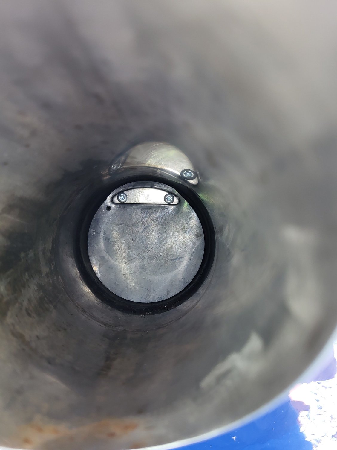

Mine have swirl things in exhuast
really only can hear them at idle
Nice rumble and well below 84
At high speed you csn hear the air coming in
At moderate throttle its pretty tame
