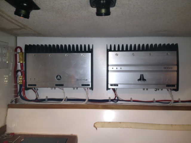

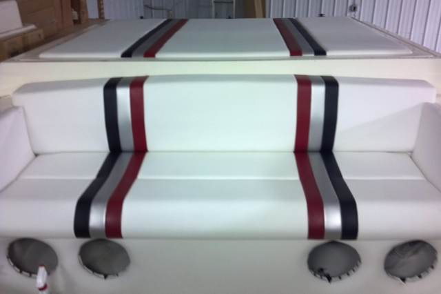

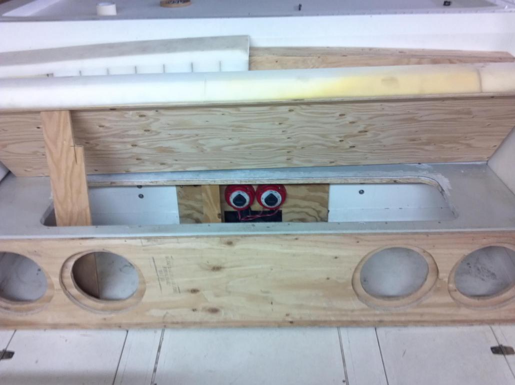

I have 4 JL Marine free airs that POUND, most of the quality is in the seat face, mines made of 2.5" of wood and fiberglass to resist the seat facing flex, thats where quality comes to play for feeling and sound, I am a fan of free air with proper amp wattage, I run all 4 off a JL1000@1OHM (STABLE) and 2 JL 4 channels to hadle all the other speakers, the boat sounds amazing, to use free air you need a good clean true watt amp...the sound is bad azz...

I personally like Alpine over the Rockford, I run the JL because of the track record and the 1 ohm stability, is that Alpine 1ohm stable? if you can run 1ohm you will get the most power out of it but not many amps can, they overheat and shut down...I am no stereo genius, but I have done many over the years in auto and boat...
The older stuff seems to be great quality like the old punch amps and such, but the newer Rockford does not seem to be a true watt amp... great rule of thumb for amps is 1.00 a watt.... if you pay that you will get good quality power...
A big power amp will push a free air sub properly, I like the free air because if your Fountain is like my Cig the extra space is much needed under seat for things.... and if your seat is not super thick and subs move the seat for sure back it with 3/4" plywood to stiffen it up, so many people overlook that stuff...
