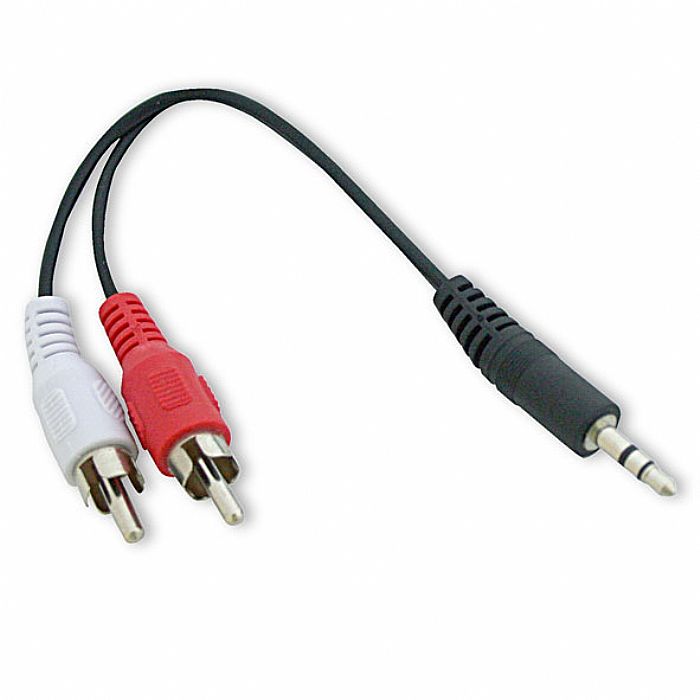

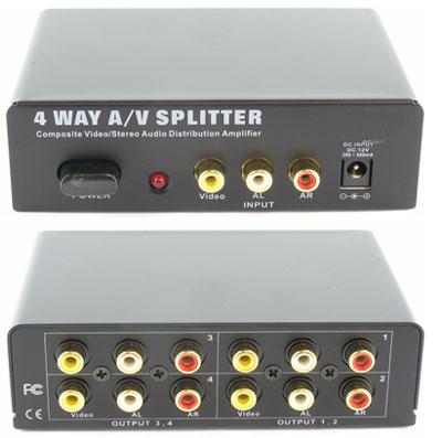

if your just using an Ipod or Mp3 player the easiest way to ditch the HU is to get a phono to RCA adapter to plug into the player....then that goes to a splitter that gets routed to the amps.....the player will control the volume. If you want to get all fancy and link other boats up then the bluetooth would need to be integrated in but the other boats need to have it as well to play the same music...its either that or you can buy a small FM transmitter and have everyone tune into the same channel your broadcasting on.

The only thing is Ipod's, MP3 players, and most of the phones I have tried sound like trash out of the headphone output.
There is a night and day difference between my computer and any of the other devices I listed.
We link boats together every year for the raftoff at Muskamoot bay. We just run RCA cables between boats and they all run of my computer program. I just have all the different Y-cables, and adaptors to connect everyone up. We tried a FM-transmitter it was pretty much useless as most boats suck at picking up FM signals.
