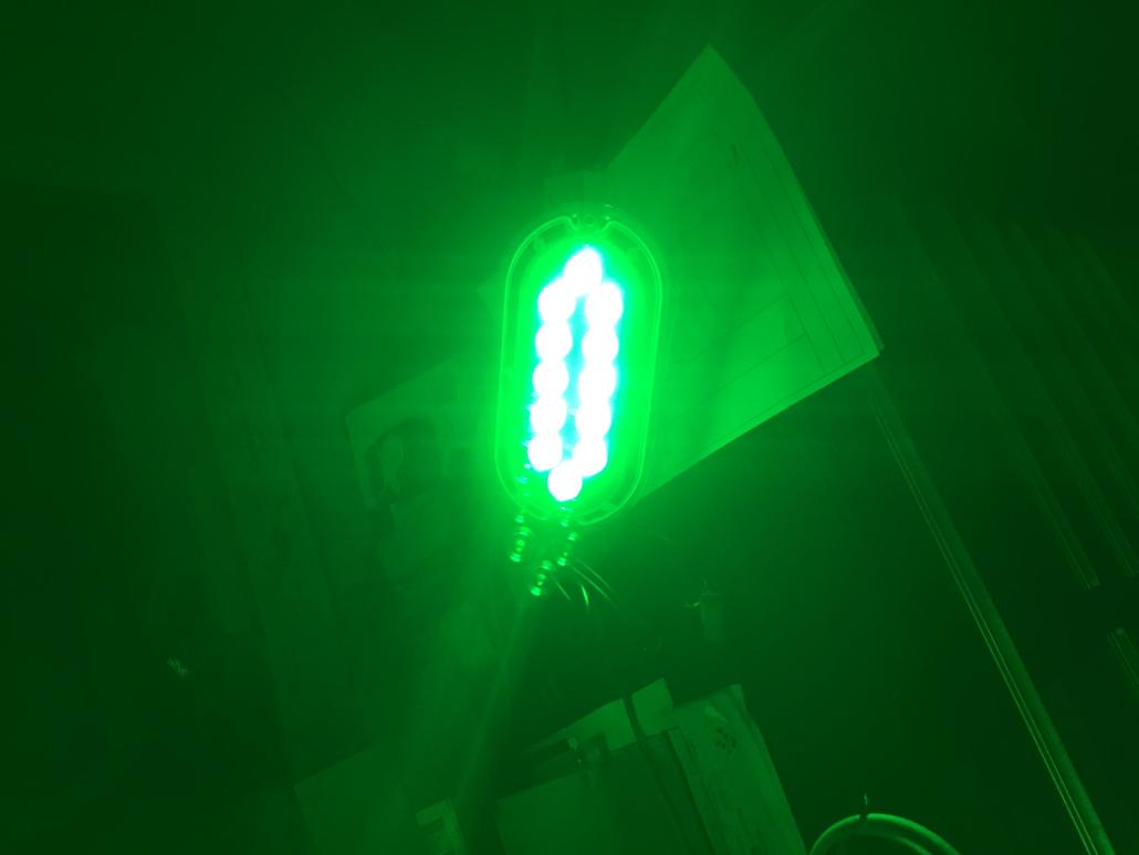

I have RGB 1300 lumen underwater. Most solid colors and RGB with a control box
$200 each
Control box is $99

Default Led
[ATTACH=CONFIG]553357[/ATTACH][ATTACH=CONFIG]553357[/ATTACH]
