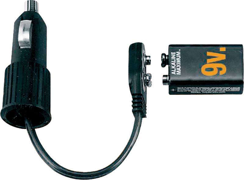

wire up a cigarette lighter outlet to the memory wire and your ground wire....then before you turn off the main battery switch on the boat, plug in one of these memory savers you can either buy or make yourself. should keep the memory long enough between uses not to loose stations.
-Wally

Did a little more research on this and the feature to be looking for is called "eeprom". I have only found a couple so far that have this feature for sure; Rockford Fosgate, Kicker, and some discontinued Alpine. JL and Fusion are rumored to have this feature, but I can't confirm this from their published specs. I'm really surprised this isn't a standard feature on all "marine" head units now that simple control knobs are out and complicated revenge of the nerds menus are commonplace . Its a PIA scrolling through menus to reset your settings, especially when you don't use the unit that often. I would bet the typical, "seasoned" boat owner uses his bot no more than once every 3-4 weeks and leaving the memory wire hooked up is an unwanted draw on the battery. Some head units seem to be worse than others. Most of the solutions out there are more geared for the short term, like changing out batteries. From what I've read, the item above that Wally shows, is more for the short term. If anyone can confirm that a certain head unit has the eeprom feature (or similar), please add it to this thread.
