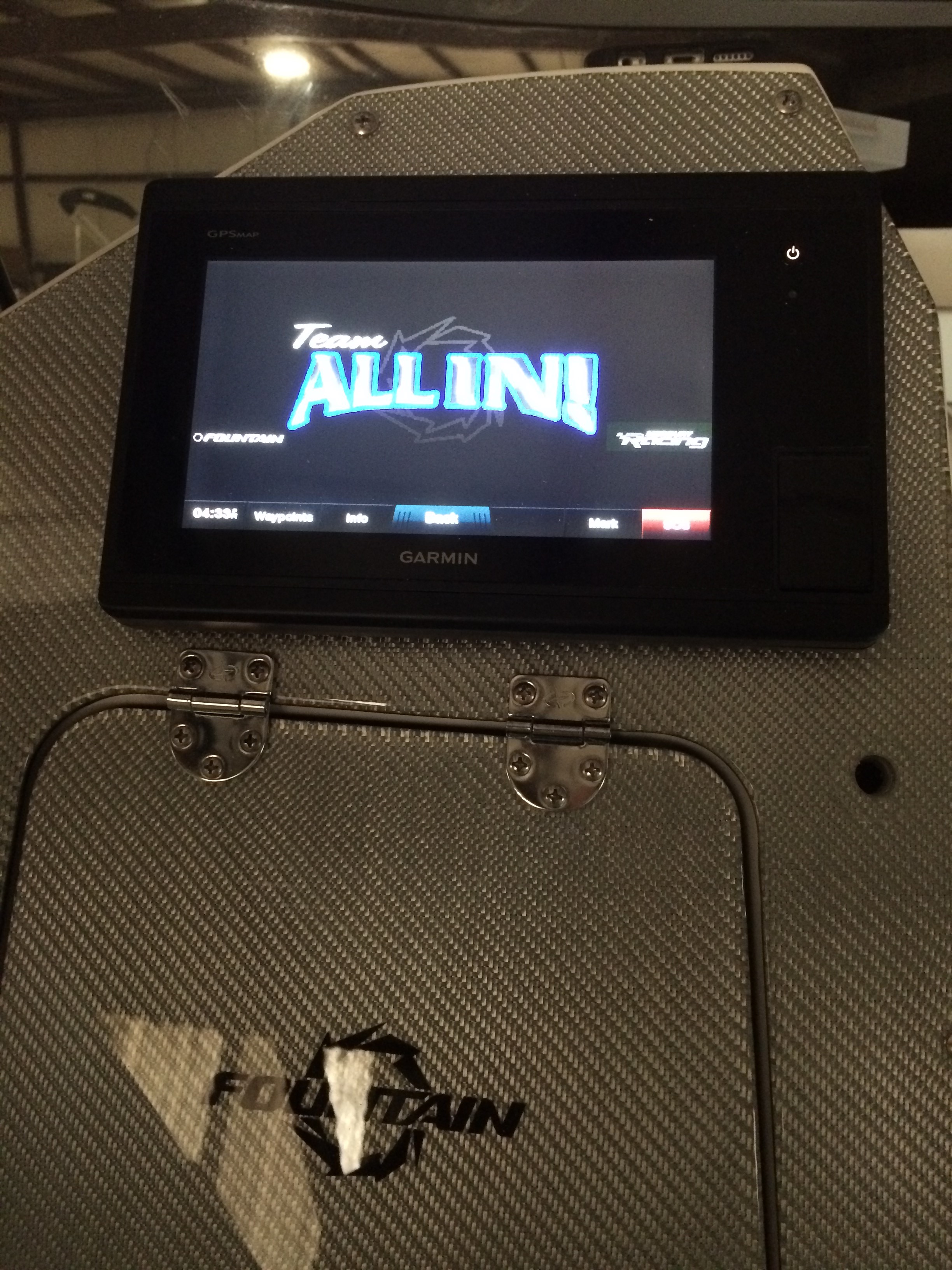

I installed Garmin 7607 and Fusion RA70N with the NRX200 remote You'll need a powered backbone and related NMEA2000 cables and T's. I didn't fully understand the backbone necessity, so had to order after I discovered that there was no connectivity.
I also would probably not buy the NMEA backbone and cables from Garmin (if I had to do it all over again). They are high compared to Amazon, etc. But at the time, I knew nothing about NMEA 2000.
Works good - but we actually don't use the onscreen controls very often. But it is a "cool" factor. I'm trying to figure out the best way to play video to the 7607 (it won't from SD card, only images/jpegs) - probably should have gotten a Fusion with more features, but again, didn't realize it until I had the equipment.

ALL_IN! 07-07-2017 04:03 PM
4 Attachment(s)
Figured out my picture problem - obvious user error!
Attachment 568969
Attachment 568970
