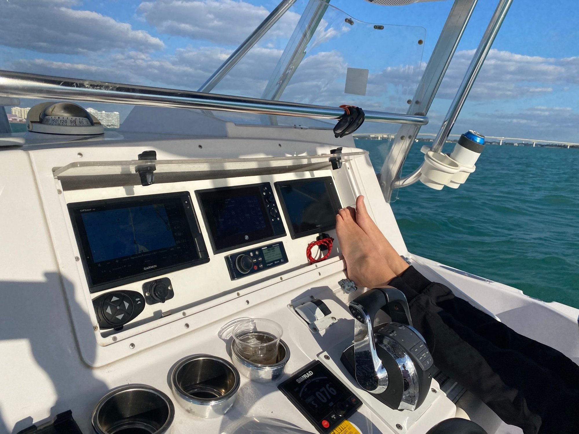

I have a 2004 35ZF with 350's, I redid my dash with
VV703
2 Garmin 942xs
...and a ton of additional upgrades. Took the smartcrafts out and added cup holders!!
motocam25 is offline

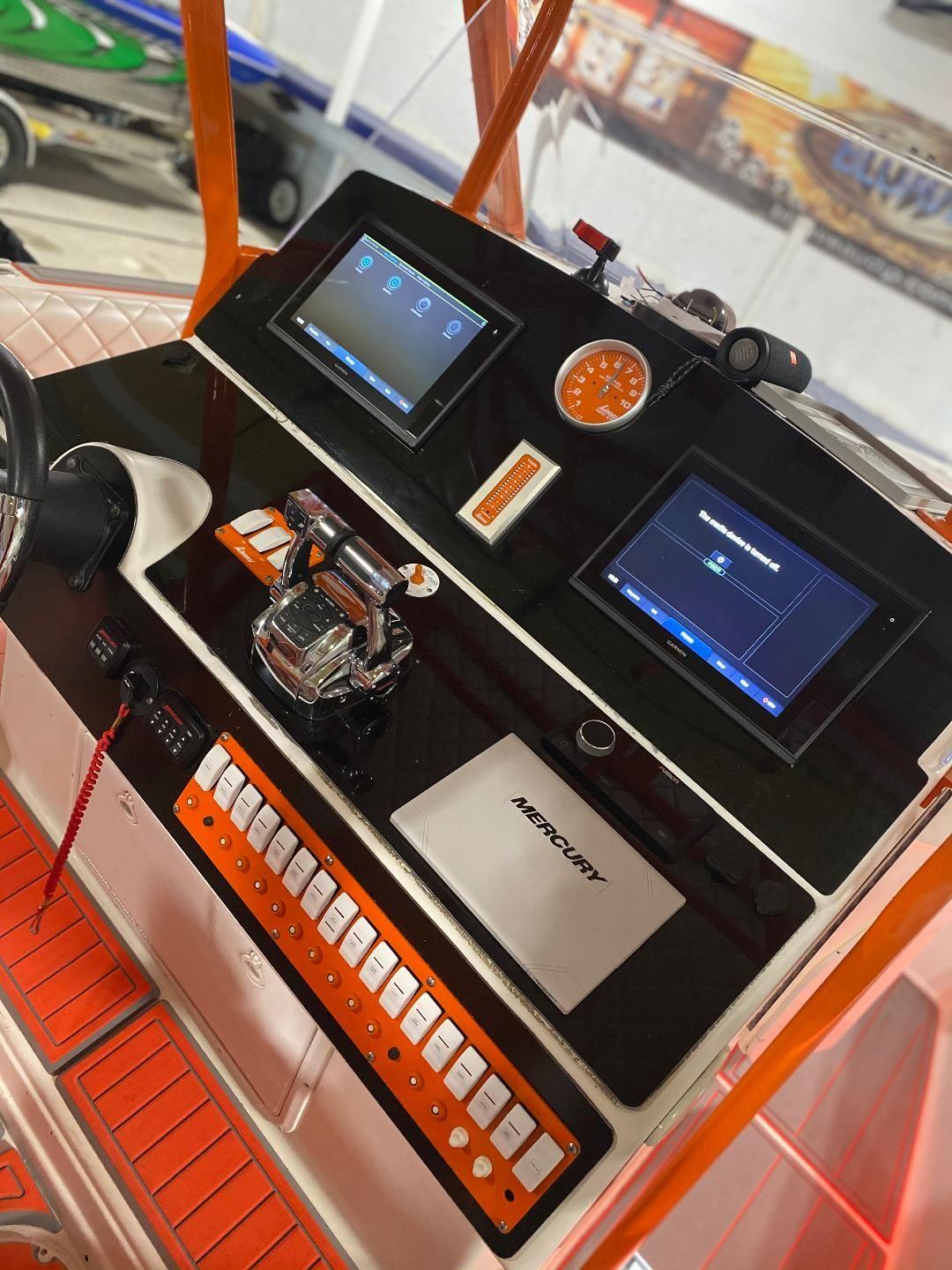

Was able to get 2 12" Garmins and speedo with a full new panel to cover the whole area. Gave it a good updated look.
JKetels is offline
^^ This! Gives you a lot more room to work with. I'd get the biggest screens you can fit/afford.
