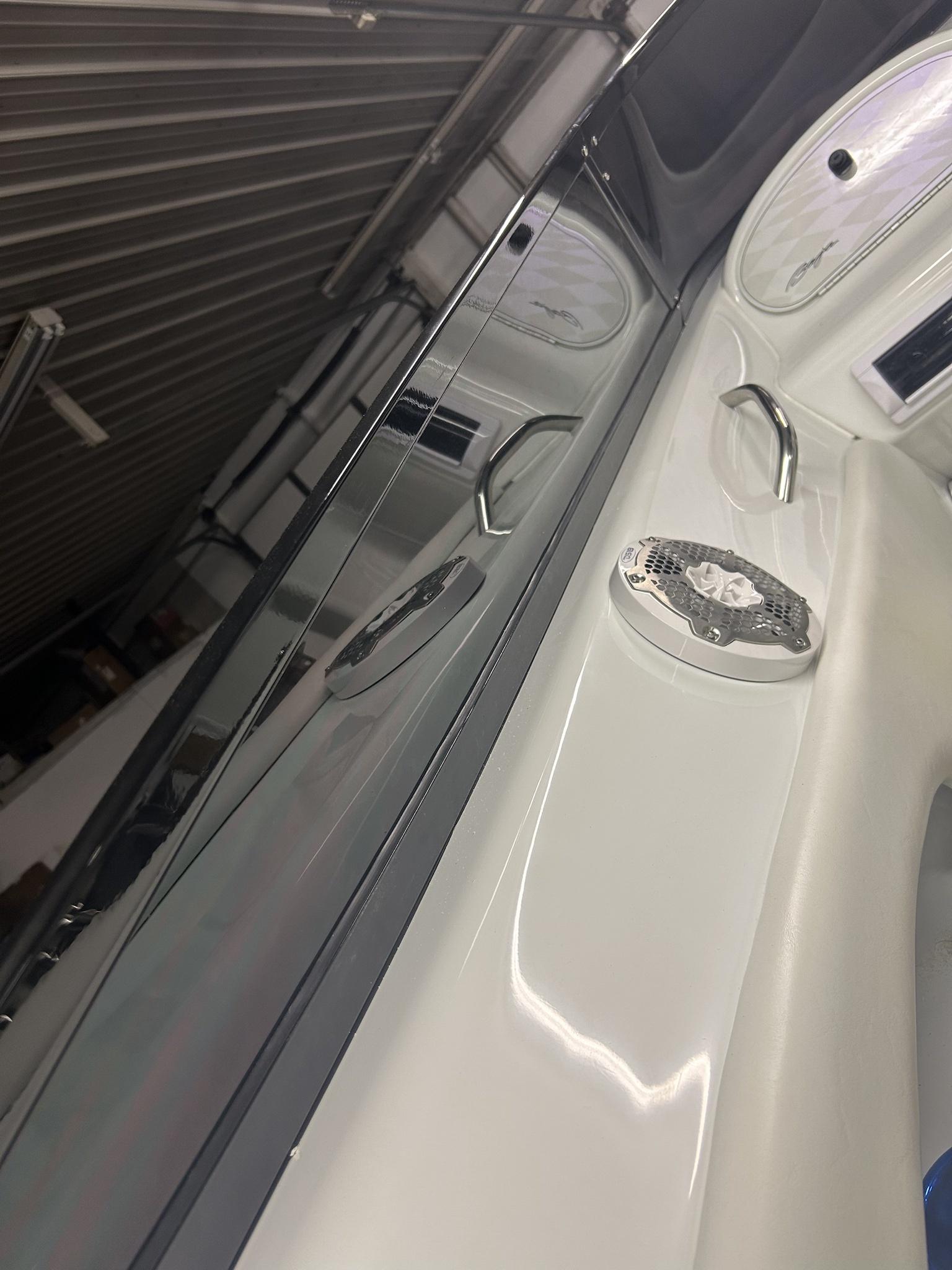

[email protected] 12-16-2022 11:53 AM
2 Attachment(s)
Did a small update to my audio setup. The boat currently had the following..
Two 8" DS18 Hydros
Two 6.5" DS18 Hydros
Two 10" JL M3 Subwoofers
Skar - 800w rms Monoblock
Skar - 500w rms 4 Channel
This did provide great sound but all of my speaker locations were pretty low in the boat so getting the sound outside was a challenge.
So for the updates I added two additional 6.5" Hydros mounted next to the top bolster seats and two 10" Ds18 Hydro speakers mounted next to my JL Audio subs. I got rid of the 4 channel amp and went with an 8 channel providing roughly 75rms per channel.
Never thought I would be throwing 10 speakers in the cockpit but why not lol.
Attachment 577525
Attachment 577526
