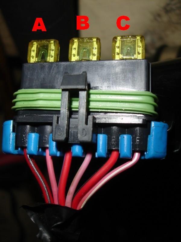

check these if you have them

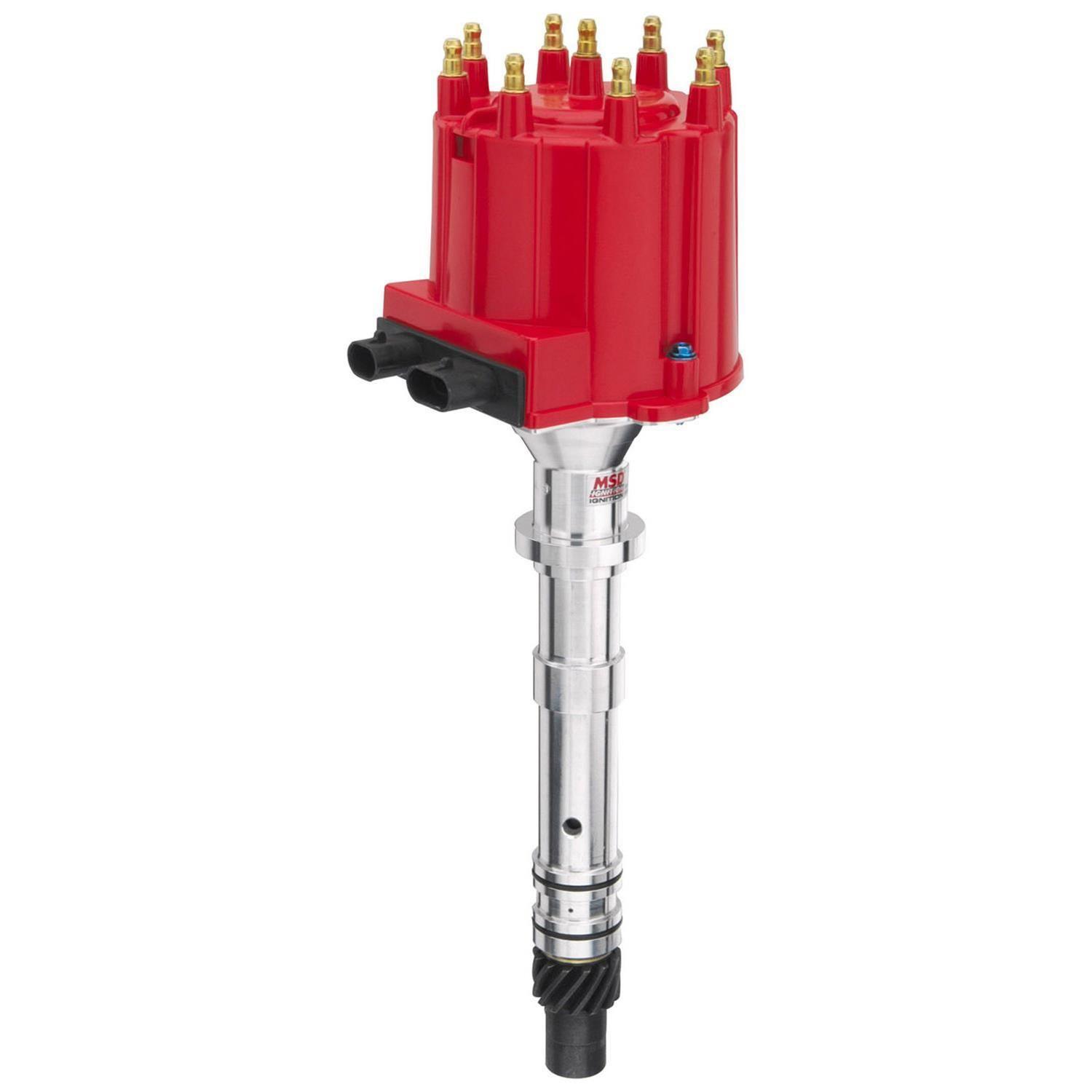

ummm…,don’t you have the wrong dist ?
#8560
You should be using the replacement for what you took out. Like the #8366 ?

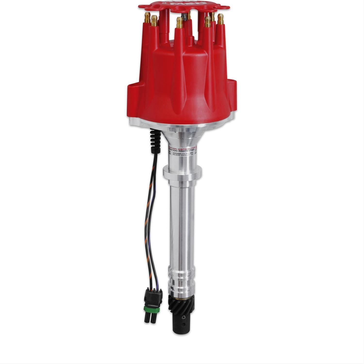

Not per msd. The 8560 plugs directly in to the msd box and by passes factory ignition components.

I believe I could have used the other distributor, but Crockett recommended the one I chose.
